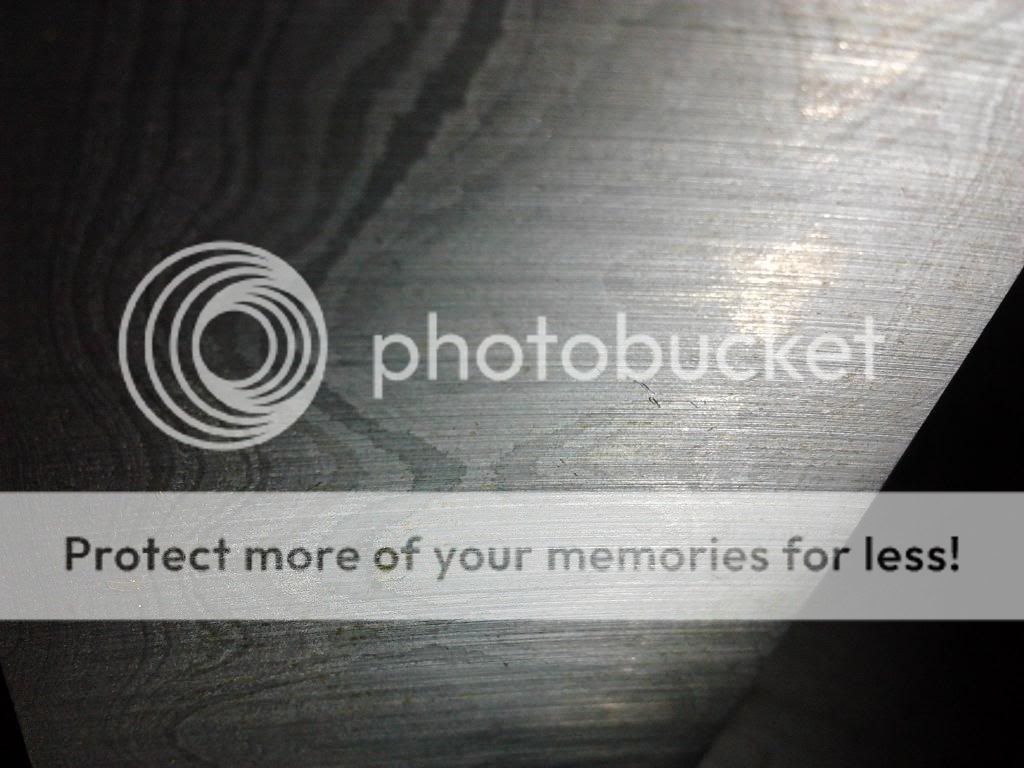

Ok, so I've got some bar stock I'm using for a project at college; I'm making a decorative fixed-blade knife out of AISI 1065 Damascus. I just wanted to ask if there was any particular step after grinding I have to take to 'reveal' the pattern besides polishing. This will be my first knife, so I'm pretty eager to begin work on the blade, but at the moment I don't know enough about working with it.

After final grinding and surface polishing you need to etch the blade in an acidic solution to bring out the Damascus pattern. Knife guys use ferrous chloride? which you can find at radioshack, or you can use vinegar or other acid type solutions.
AISI 1065 Damascus. Just what is that. You can get some ferric chloride dilute it with say three parts of water and place your blade in there at a 600 grit finish and clean, for about 5 minutes check it out and see if etched enough for you or etch longer.
Rub your blade hard to clean with super fine steel wool, paper towels, cloths. or buff with a soft wheel with white or green rouge. Frank
Damascus is a mix of two or more steels with different reactions to an acid etch.
We're not quite sure what you have!
Try to CLEAN a piece and dip in vinager for a little bit to see what you have before spending to much time on it.

I'm pretty sure the mix includes at least 1065 carbon steel, and my guess as to the other would be nickel. I had no idea about the etching, thanks all. It'll have to wait until sometime later this week, but I'll try to post pics once I get the basic lines done.
Some patterns look better with bevels ground in and some look better with bevels forged in. Hardto say without seeing what ya got. Is this going to be a wall hanger or using knife?
Ferric chlorid, purchased for radio shack as PB etchent is probably what you want to etch it with. It's the standard. IIRC it's like $10-$15 and mix it 4:1 with distiled water. It will be enough etchent for MANY blades. Hundreds!!
Get us some pics or at least a description from where you got it and we will be aable to help you more.
This will be a decorative knife, for sure, I don't think I'll be bothering with heat-treating it. I'll post a pic of the bar stock tomorrow morning.
I got the steel from my local knife shop-- I can ask them if they know the exact composition Monday as well, since they're pretty much right beside my college.
Damascus etches better when it's hardend. It will be more defined etch. The place you got the steel from would be the place to ask about how to grind it for best look and they might also ht for you. A knife ain't a knife until its heat treated!
They don't have the facilities for heat-treatment, but I think my school does. I'll just ask the sculpture department real nicely. So, just to be sure I have the order correct... grind, harden, then etch?

You asked if it's grind, harden, etch. You're on the right track. It's more like this--- :)
Grind
Harden
Temper
Finish Grind
Sand
Sand
Sand
Clean
Etch
Sand/polish
Etch
Sand/polish
Etch
Sand/polish

Oh, and here are some pictures of the bar stock itself.
