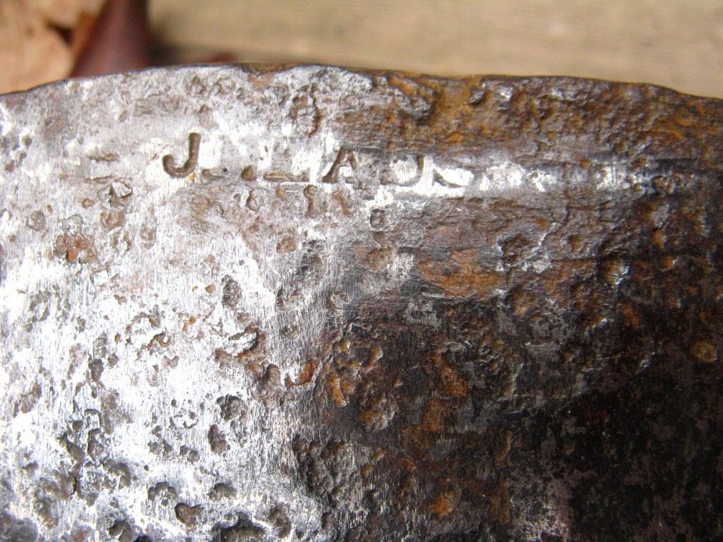

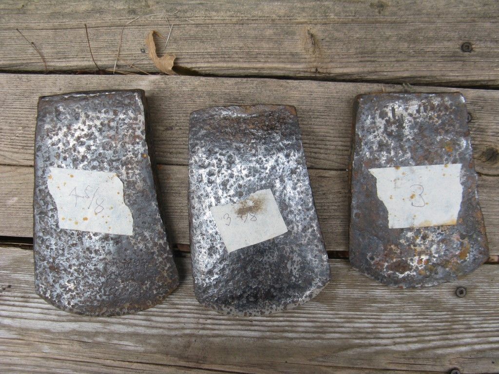

These three axe heads were unearthed over the past few years via metal detector at different pioneer homestead (Empire Loyalist 1783 +/-) sites in the general vicinity of Kingston, Ontario. Weights (in lb) are recorded on the pieces of tape. The hobbyist that found them sort-of cleaned them up with an angle grinder (whoops!) but as recovered artifacts from the early to mid 1800s (?) they are still intact enough to be re-used. The shape of these is quite different from American patterns and all of them have prominently raised cheeks.
One of the heads (middle piece) has a faint stamp which so far I have not been able to determine as to Who/Where/When, but suspect it to be of UK origin since there is no Lauson or anything resembling that name in the Cdn Tool Manufacturers 1820-1914 list. The British gov't granted loyal Brits, that fled from the 13 Colonies during the American Revolution, 200 acres of wilderness in Upper or Lower Canada and outfitted them with tools, hardware, food staples, crop seeds, window glass and clothing enough to erect a log house, begin clearing the forest and survive through the first winter.
J. Neads
Bowmanville, Ont.
1865- 1871
axes
(from that same reference)
GD! Man, you are sharp at deciphering these things, and quick too. I never read J NEADS into this; figured the E was an L. and the D was a U, as in J N LAUS..
Bowmanville isn't very far from Kingston and isn't very far from Peterborough where the J Story (1864-1871) head (that you ID'd 2 years ago) came from. Now I'm beginning to think that shape was some sort of regional axe pattern.
GD!...Bowmanville isn't very far from Kingston and isn't very far from Peterborough where the J Story (1864-1871) head (that you ID'd 2 years ago) came from. Now I'm beginning to think that shape was some sort of regional axe pattern.
Either a regional pattern, or Neads got his axes from Story. ;)

Was there an Upper Canada axe makers guild at the time or did all of the commercial blacksmiths emulate designs that were popular in that particular area? The weird thing about towns along the St Lawrence River, Lake Ontario and Lake Erie is that comparative/competitive American goods were 'right there', especially when the water froze over. Blasdell, Washburn and probably some others, who made axes in Ottawa until the 1880s (the predecessors of Walters) far as I know never made patterns such as this.
That middle head (J. Neads), as well as the similarly old one that you found (G. Story) both resemble the profile drawing of an "American axe" that appeared in an old book, "the first edition of which was published in 1863" (before translation from German to English):

You are the 'very best' Steve, and thank you. These (incl. the 1864-1871 Peterborough, Ontario, provenance George Story, of two years ago) are unlike any classic or modern axes I've ever seen. Why it is that 4 of these (probably all 150 year olds) 'oddballs' have crossed my door escapes me. I think these were meant for pioneer homestead type work, but the cheek profiles (curved in two directions) must have been daunting for an ordinary small town blacksmith to try to make.
Any time that I see that pattern, it is a giveaway to it's age. It isn't unique to Ontario, but it unique to a time period. That style tends to have a concave shape, thin eye walls and a heavy poll, as well as stamps that look like old typewriter fonts. Easily 1800's, and very nice.
Far out! If the Sheffield 'Canada Wedge' depictions are typical of this antiquated pattern it would seem the polls were made of steel and hardened to some degree. Perhaps somebody out there (preferably in Canada in order to avoid outrageous shipping costs) would like to try to resurrect one of these (hint hint; Remzy) and thoroughly put it through it's paces. One of the unstamped heads is 3 lb and the other is 4 5/8 lb. I will try to find a local museum 'homecoming' for the J NEADS head (Bowmanville has effectively become a commuter suburb of Toronto now) but the other two have no identifiers on them and therefore smoothing off the rust pitting, re-sharping of the blades and re-hanging them won't jeopardize the value nor offend anyone. It would be interesting to see and hear how well primitive steel (and wrought iron?) fares against a modern axe.

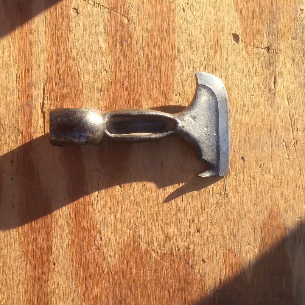

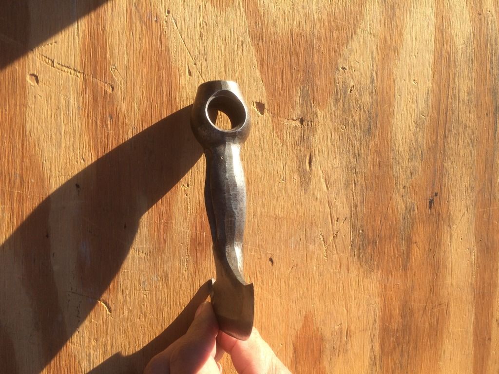

This might not even an axe and it looks like an old multi tool. It has an axe like edge, gut hook, hammer poll and threaded eye. Any help would be greatly appreciated.
Rick
Rick
It's a "Skachet".
It's a "Skachet".
The Skachet was patented in 1965. The labels said "Made in Japan".
The patent document has descriptions of intended uses.
https://www.google.com/patents/US3187354?dq=3187354&hl=en&sa=X&ei=rCgiU9j7JYKAogS5y4HoBg&ved=0CDQQ6AEwAA

J. Neads
Bowmanville, Ont.
1865- 1871
axes
