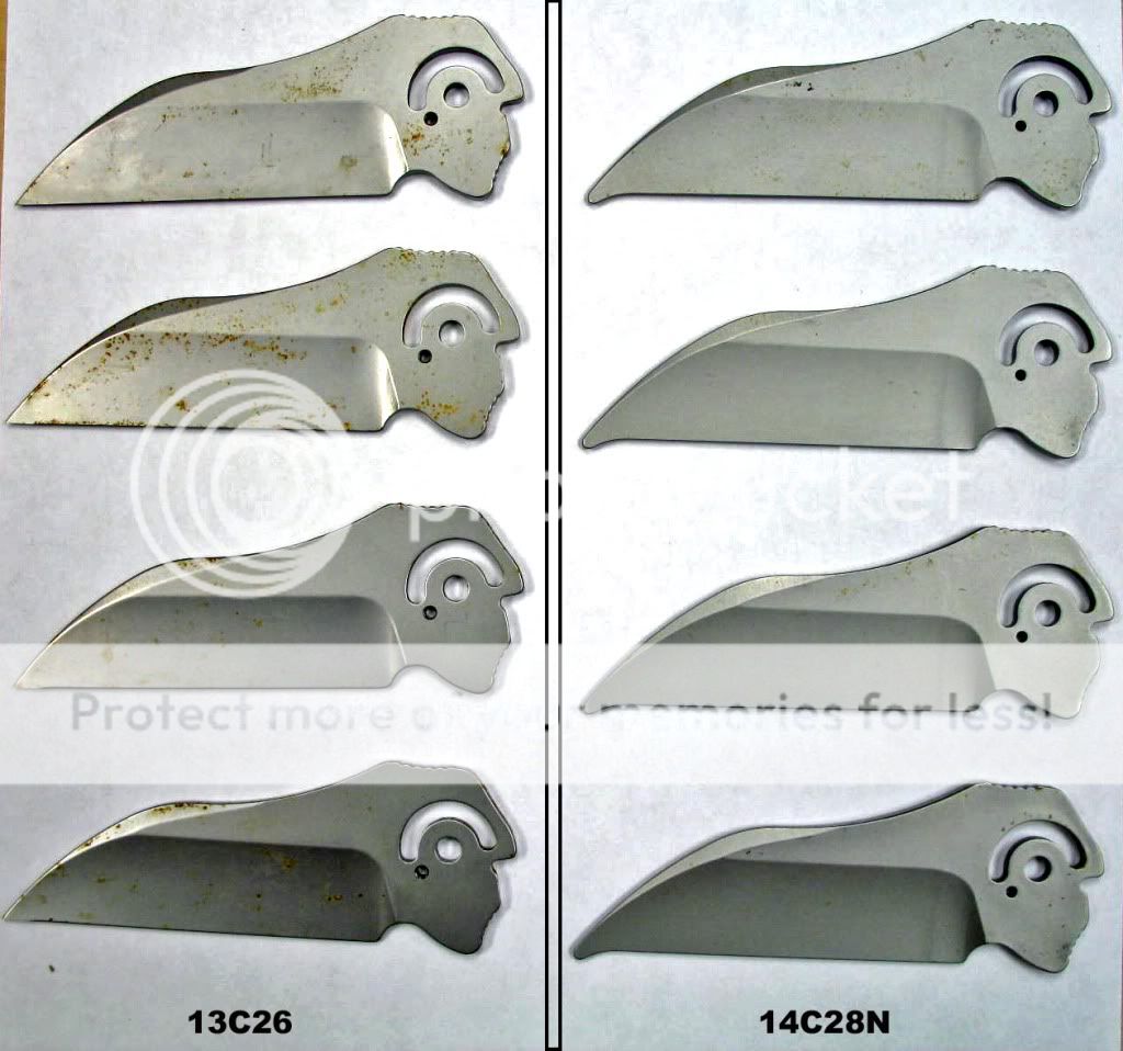

There's a lot of their knives that I really like, but the problem is all of them (that I own) are bead blasted, which really seems to attract rust spots where I live (NY) without even being left wet.
Just sitting on my desk my Kershaws have all gotten some rust speckling, whereas all my non bead-blasted knives remain completely rust free. What gives Kershaw? Is a simple satin finish or stonewash too much to ask?
Kershaw has many models that are not bead blasted. Clean the bead blasted ones with Flitz or any similar mild polish and it will fix it up. If you don't want to do that, just don't buy them. More blades for me:).

As a volume manufacturer (please try to keep this in mind), our factory is set up in ways that are different than the specialty manufacturer. Our primary business/sales are based on moving large quantities of USA made knives. Not specialty manufacturer quantities, large quantities. With this type of high traffic business, there are deadlines, cancel dates, fill rates, quota's, etc that have to be met. The consequences in missing them, or coming up short on a scorecard is unacceptable. Our factory is set up to meet these stringent expectations, and we can bead blast in quantity, lots of quantity.
Although you seem to feel that a satin or stonewash finish is simple, it isn't for our business as we have to meet our high capacity demands. With the set up we have in place internally, this would just not be possible with these other 2 finishes. So to answer your question above, that's what gives.
I will say that corrosion is not a complaint that we regularly hear about, but apologize to those who this have negatively effected.
Our 14C28N core steel that we use has addressed corrosion, and is an improvement over the 13C26 we were using. Additionally we do prep the steel prior to bead blasting to further assist with corrosion resistance. The below image shows the improvement with 14C28N in identical fog test(s) that were conducted on two bead-blasted samples.

Lots of sweat here as well and no problems with rust on the 14C28N. I did have some with the 13C26 before I started using Scotchbrite pads on them. I have a JYD that looked about like the 2nd 13c26 blade that Thomas posted. It is now polished with 2000 grit sandpaper.
May and June in Kansas City = lots of sweat and very high humidity. Carried my 2445st at work all last spring and summer no rust at all.:thumbup:
Thanks for the pictures Thomas.
