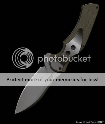

Here’s my Before & After. If you followed my tutorial on how I photograph knives your corrections shouldn’t be any more complicated than my corrections were here.

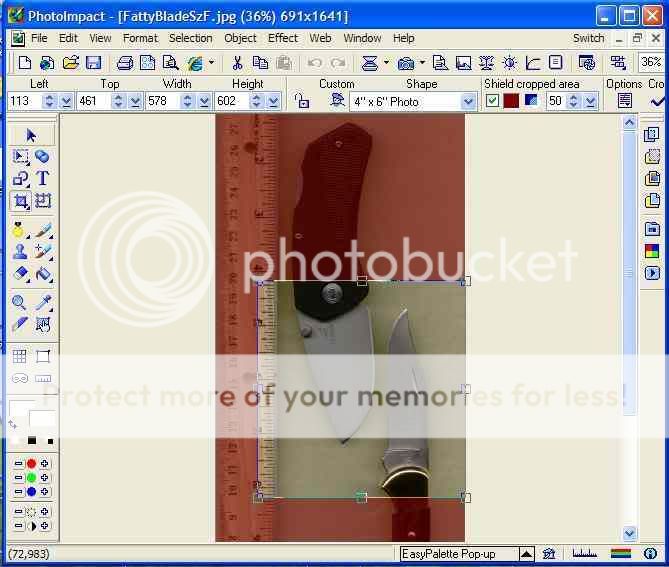

Using Ulead PhotoImpact -
Cropping -
pretty easy and allows one to adjust the area to be cropped using those small square handle points.

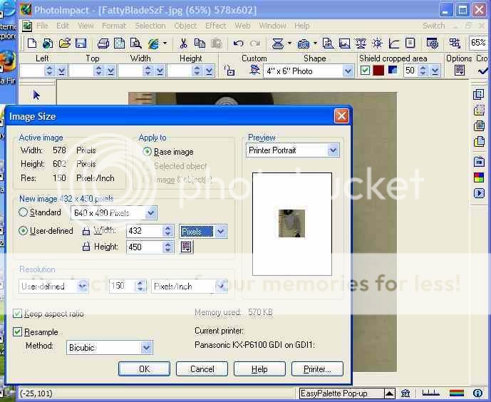

Resize -
allows resizing by percentage, pixels, inches and centimeters.

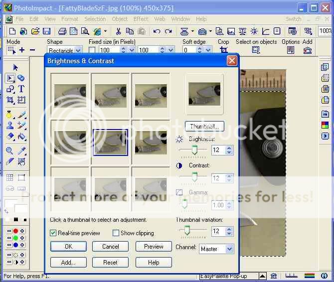

Brightness and Contrast adjustment -
current image surrounded by 8 sample adjusted images - by checking the Preview box one can see the effect live on the full image too. I use the samples to get an approximation then use the adjustment boxes to fine tune the image to exactly what I want by looking at the changes on the full image.

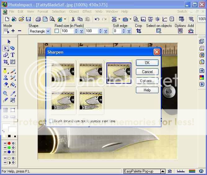

Sharpen -
again Visually based - I normally just use the lowest amount 1 (the leftmost box).

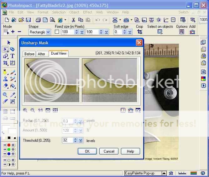

There is also Unsharp Mask too that allows the expected radius, amount and threshold - I only use this for finer control -

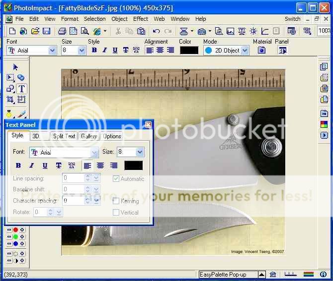

Adding Text is pretty easy -
allows font, size and color selection (there is also anti-aliasing under options tab)

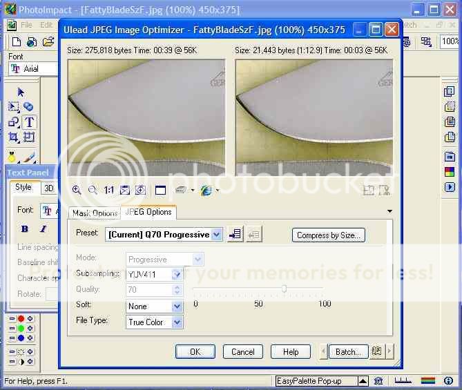

Save as -
This is an underestimated and important step - first resizing the image is important to keep both the physical size and the FILE SIZE down.
Then when saving using an unnecessarily "high quality" compression (ie: large file) can mitigate the effort to keep the image size small. I use 70% JPG on PhotoImpact - which is closer to quality 5 in PhotoShop and Elements.
However for these screenshot which are larger than my usual image sizes I used only 33% - which may seem like "cr*p" quality - but again the huge advantage I have of being able to see a side by side visual comparison when saving - I found the 33% by using the compression by size then checked the side-by-side image quality - yes, of course there was degradation - BUT I think these screenshots are legible and make their point - yet they are all only about 40-45Kb each - much kinder on bandwidth and a lot of people still on dial-up (remember BladeForums is international and not everyone is fortunate enough to be on broadband).......

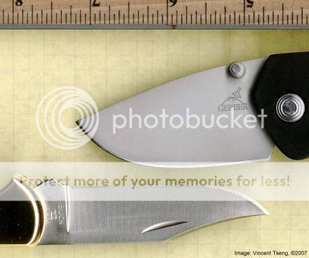

After - the end result after 6 PhotoImpact steps -
1) crop, 2) resize, 3) rotate 4) brightness/contrast, 5) sharpen, 6) add text -
saved at 70% JPG (about the same size as quality 5 in PhotoShop or Elements) -
450x375 pixels, file size = ~21Kb.

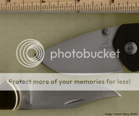

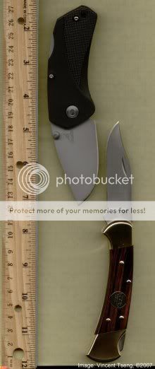

Before (original scanned at 150dpi - 1147x970 pixels image) -
After - 2 resultant photos from same photo above
Both 1) rotate, 2) crop, 3) resize, 4) Brightness/Contrast, 5) sharpen, 6) text
Because of the size of the scanned image (and 150dpi is very modest) I can crop and show more detailed area to get the second photo of the marks/etches on the knife
