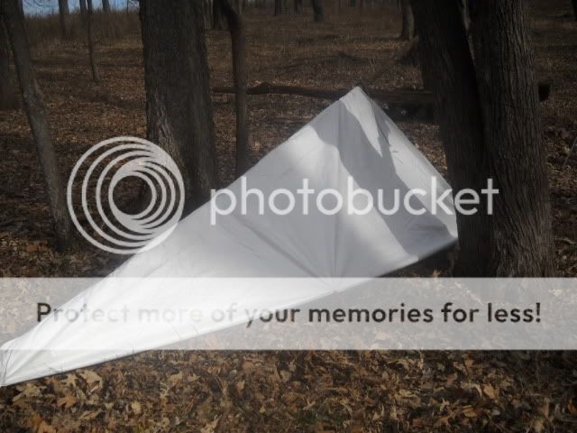

I want to tell you folks I have a bunch of money wrapped up in gear. I have for years. But, you don't have to. Cheap and functional shelters are easy to make. Don't think you need to spend hundreds of dollars to enjoy the woods.
This is a tutorial on a free or very cheap shelter you can make from Tyvek.
[video=youtube;Gu5zZqkB190]http://www.youtube.com/watch?v=Gu5zZqkB190]Improvised Tyvek A-Frame Shelter - YouTube[/video]

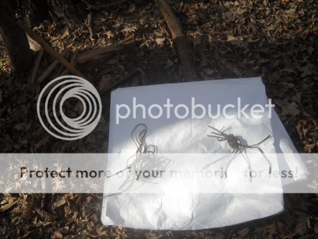

All that you need that is man made is some cord and a 9'x9' piece of Tyvek.

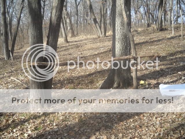

After finding a good shelter site, I put up a pole that will support the ridge pole.

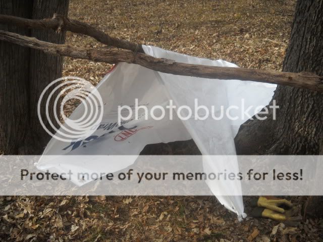

You can then lay the ridge pole and on the center fold attach the tyvek to the main pole with a button.
Once that is secure, stake down the front corners.

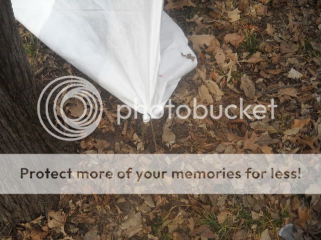

Here is a close up of a button. It is just some duff put into a pocket of the material and secured with a slip knot.

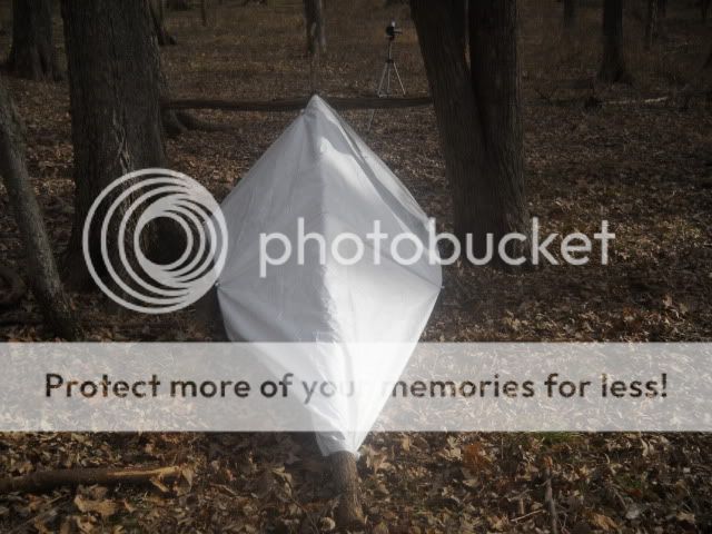

A side and rear view of the shelter.

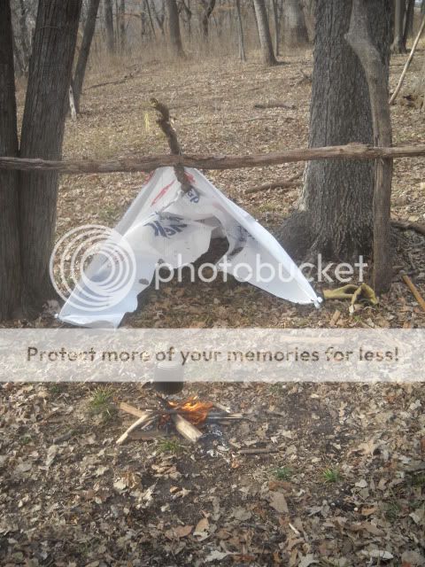

The extended ridge pole can be used to hang a pot over your fire. You can also see that the extra material has been folded under and acts like a ground cloth.
This is a great shelter for people just getting into bushcraft.
