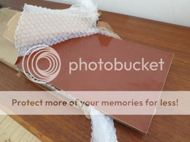

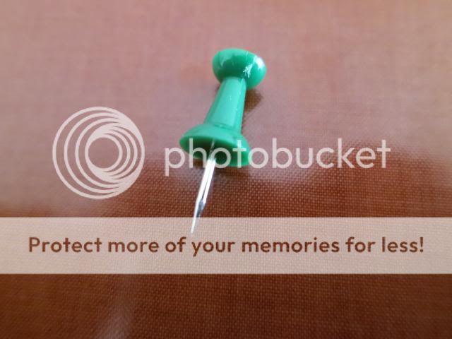

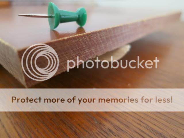

I found 18x7x(2/5)" slabs of industrial canvas Bakelite for 20$. Bakelite is a a thermosetting phenol formaldehyde resin and canvas bound its the weird Belgian ancestor of micarta. Has any one used this material for knife making? Pros, cons, hazards? :)
That looks like regular linen reinforced phenolic to me. It should work fine for handle scales. And by the looks of it, it isn't old, it is current production.

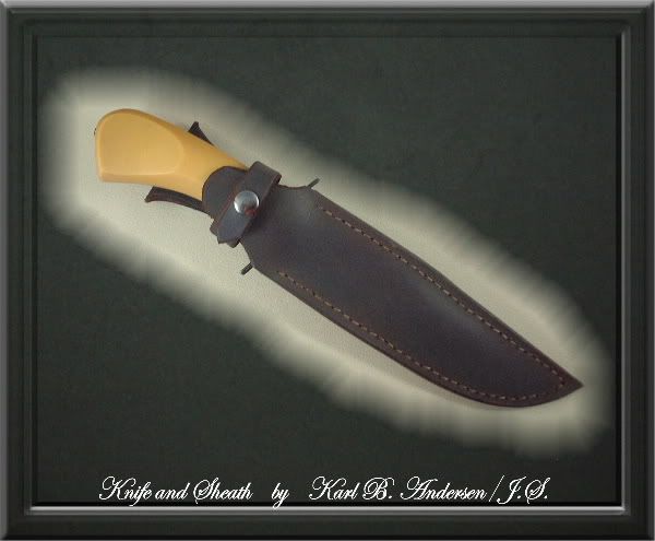

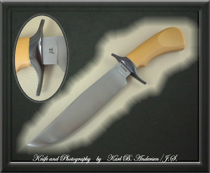

Here's one with some of the original Bakelite.
Thanks Nathan and Karl for the helpful answers. Karl the knife looks fantastic! I've done some research and every thing that is said in the tread kind of ads up. The material is "vävbakelit" witch translates to woven Bakelite or cotton fabric re-enforced Bakelite (so its different from regular Bakelite as Karl said). Its made by a current hi-end Swedish maker called Fermprodukter. I guess that Micarta was a "trade mark"-product that became synonymous with a material in everyday language usage. Over at this side of the pond were the original Micarta never made it big this material is still sold under the name vävbackelit (cotton fabric re-enforced Bakelite). :)
