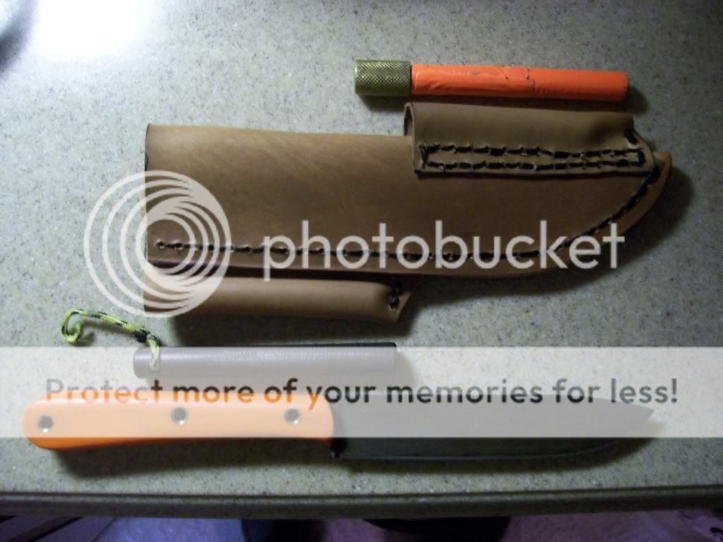

Hey Evolute, thanks for the review you did on this fire starter.
I am going to continue using my 4" fire steel after reading
your review funny you mention that firesteel I just finished
making another sheath for one one of my knives that I made
I like to carry a fixed blade with a firesteel and a sharpener.
On page 326 of Nature Bound by Ron Dawson he says
that adequate clothing and a quality hunting knife and stone
are essential. Then he mentions the rest of his survival
and first aid gear. But I thought I would go and do it better
in my thinking and have a way to start a fire too. Here is the
pic of my hand made sheath to holed my hand made knife
and 4" fire steel and E-Z lap model M sharpener.
I was thinking of getting one of them other fire starting products but will
just stick to what I have now thanks again Evolute.
Bryan
