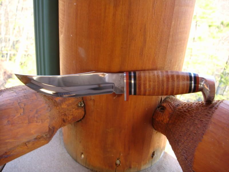

i bounght this one @ SMKW on my honeymoon. i didnt have the intention of using it i just liked the looks
