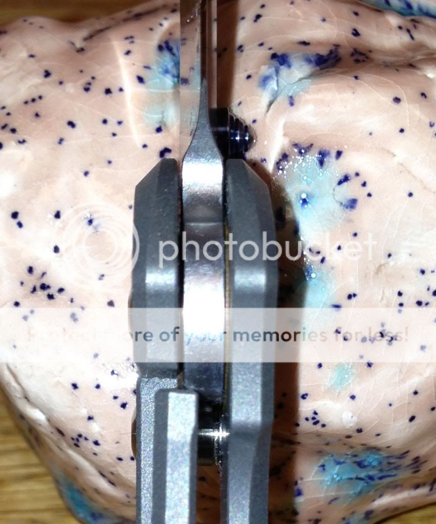

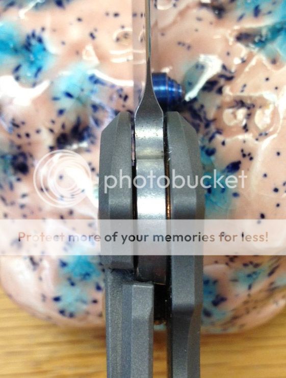

I disassembled my small plain Jane 21 for cleaning/lubricating and upon reassembly I noticed a change in the lockup percentage. I disassembled again and reassembled to see if it would change back and it remained at the new lockup percentage. Odd? I have cycled it repeatedly and it stays the same. I have applied pressure to the spine to see if it would slip and it does not slip closed, although the pressure applied wasn't that great. Any thoughts?
Lockup Before at Appx. 50%:
Lockup After at Appx. 25%:

I've noticed that if the stop pin screw is loose then it will cause it to have later lock-up, maybe it was loose before you disassembled it.

If it were say, 10% lockup I would be concerned, but 25% seems like it is locked down pretty good.

I've seen this with pretty much every Sebenza Ive had & taken apart (around ten). I figure it is because the stop pin sleeve gets minutely flattened where it contacts the blade tang & it gets rotated upon dis/re-assembly effectively adding more material there and causing the lock to contact earlier. Dunno though. Just a guess.

Every CRK I've purchased new had this happen. Usually they come to me from the factory around 75% lockup. I use it for a few weeks then clean it and it always goes back to about 50% and stays there for as long as I have it. Even after multiple cleanings, it always stays at 50%.
I agree that it may have something to do with the stop pin sleeve being rotated after wear.
