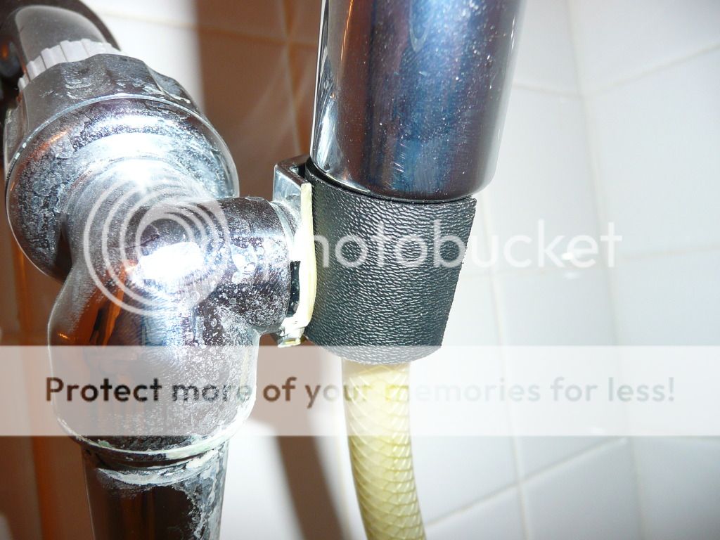

So a few days ago, the clip that holds up the shower head broke.
Went to the home depot store, and they don't sell shower heads by themselves. Even worse, a new shower kit costs over $100!!!
So what did I do?
Make a new clip out of Kydex.
Not sure if I should be proud of this, or embarrassed that I didn't just buy a new shower kit...
Thanks for the kind words guys
I'm learning that Kydex can be pretty useful!
Still very new to the material, and hopefully my next Kydex project won't be fixing showers!

That's pretty cool. Ours did the same thing. I don't have kydex so I just went to walmart and bought the $3 part to fix it. But your way is more fun.
It's a little small, but all I need is a bigger scrap piece and I'll be set!
Currently it's working fine though, gets the job done!
I have one of those pivot arms for our shower head to adjust the height. It had a fiber washer in one of the joints that started leaking because it got compressed too much over the years. I made a washer out of Kydex for it and it's been 5+ years.

Wow! Fixing a shower head clip is exactly one of the first things I used kydex for. That was a few years ago. That's amazing that we both used kydex for the same obscure fix. Cool.:thumbup:

Don't be embarrassed, be proud that your fix will last one heck of a lot longer than the original part did.
