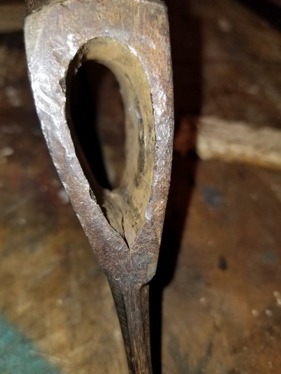

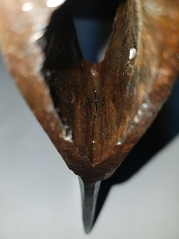

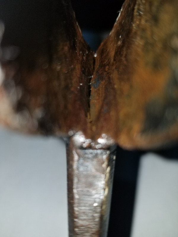

Will you be re-hanging your Acme hatchet? I ask because if so I have a request to ask of you! I got this one awhile back; View attachment 1194371
And much to my surprise it appears forge welded! Inside In front of the eye there's a clear "crack"(incomplete weld). Otherwise it appears like a modern hatchet

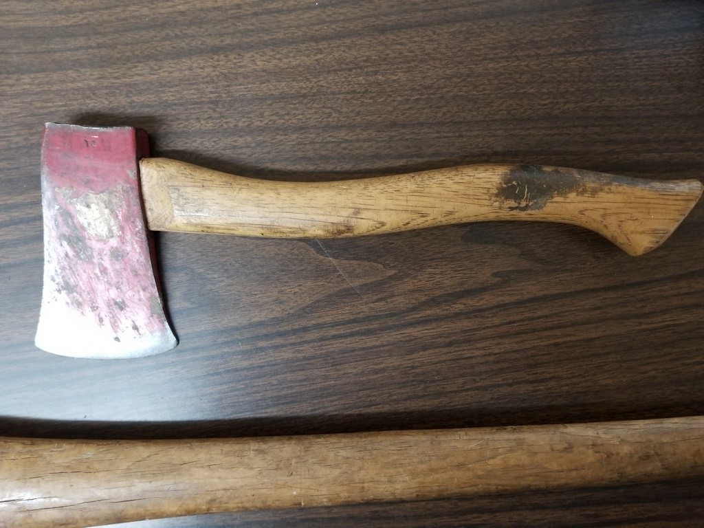

I have an old carpenter's hatchet that the handle is loose on that I need to address one of these days. I don't even know the maker of it. But it looks like the lads were not bashful the day they put the company's mark on those ACMEs you two have ... Nice! I am glad someone is finding some of this stuff as it is somewhat scarce here.

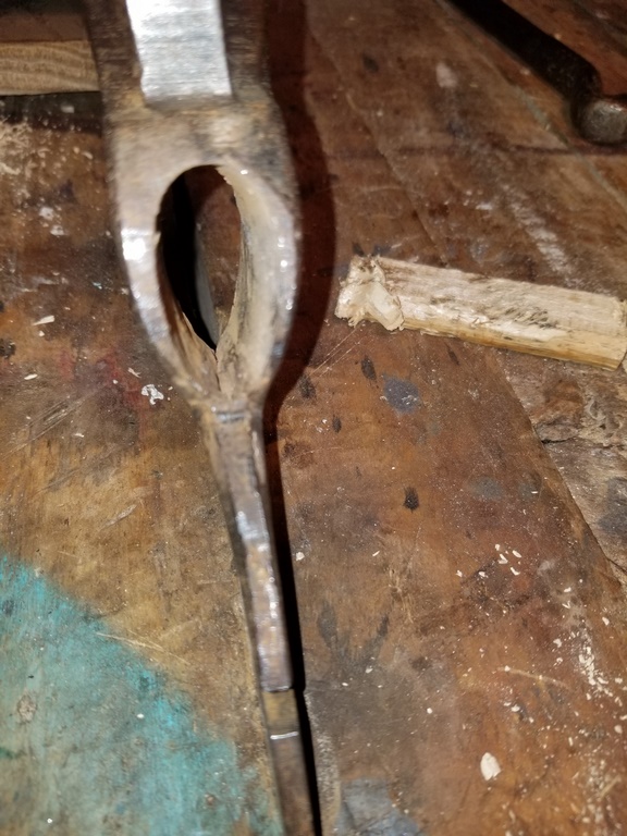

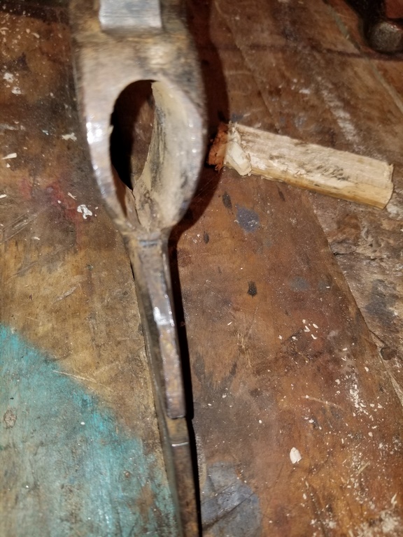

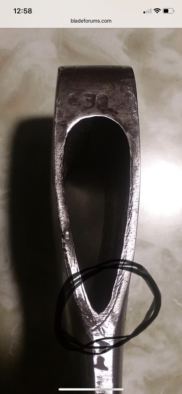

Here you are sir.
Thank you! I think I can see a weld on yours... Hard to tell.
Looking at in good light does the steel appear to you to have been folded together and joined in front of the eye?
I'm debating just putting mine in vinegar just to find out.

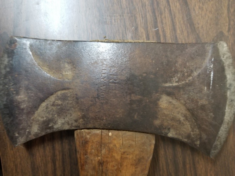

I recieved this in the mail today. I bought it for 25 bucks +shipping of fleabay. I was really surprised to see it for so little! It's forge welded and it's a Kelly. Has 32 under the poll and a (the) temperers mark in front of the eye. Weighs #3-12.2oz.
I've been filing it now for about a half hour. I'm almost done. It didn't need much. Thanks for looking!
Josh,judging welds by even some very good photos is often prone to error;but just for giggles,let me bring up other causes for just such "cracks".
Yours,quite possibly,is the effect that smiths of old called "brashness".It is when the force used exceeds the elasticity of steel and the pressure ruins the crystalline lattice,creating often just such ragged-looking tear.
So possibly when that eye was slitted,or drifted to size consequently,it was done too fast or too forcibly for temperature regime used,tearing vs distorting steel.
Here you are sir.
And this case(thank both of you gents for great photos,btw)is possibly the second variant that i wanted to mention:Sometimes when eye is obtained(by whatever means)it's circumference is longer than the finished eye will be in the end.
Since the axe is normally forged heavily from the sides after the eye is formed,that extra length gets closed up in a cold-shut(it's surfaces are oxidised by then and the forging T is usually well below welding so it does not form a weld).
So it's that extra little dead-end in the front of eye that is just closed shut forming that fold.
Again,it's very difficult to judge by photos,plus i'm nowhere near as knowledgeble as i may come off sounding,so please take this with a Very large grain of salt.

I can always tell if an axe head is true temper Kelly when it has these lines around the base of the eye that intersect. I guess it was part of their process for a certain time period. Super cool axe!!
Along with the temper marks and even the 3 2 stamp.

I was hoping you'd chime in. I had a suspicion that something else was afoot. Usually it's obvious when a tool was forged in the old way. And when that "crack" in the front of the eye is accompanied by the other tell tale signs it does tell the story.
But by itself seemed suspicious to me. But at the same time, without knowing how it could result from more modern construction practices, it did seem to point in that direction. I'm glad to know how that seam or crack or whatever I'm supposed to call it can be formed. Either way they're good hatchets! Most likely Kelly's. Thanks for chiming in Jake! Your input is much appreciated.

Thanks! I'm pretty pleased with it. I've been working on it for hours at this point and I just finished. I'll post pics tomorrow.
I thought those lines were where someone cut the excess wood off the handle after hanging?? I always pictured them being mechanically hung with a big "shelf" under there that needed to be cut off. Interesting.
And this temperers mark appears to be two T's opposed from each other. It's different than the mark on my stiletto. Neat stuff.
I thought it was a total steal at $25 + shipping.
