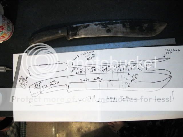

I have been reading a lot about the J.E.S.T Bolo knife. For where I live and romp in the woods I think it is the perfect large blade for me. However,not being able to purchase one I have decided to take a run at making a few.
What are your thoughts on the design in general? What would you change if you could, on the one pictured?
I have decided to go with 5160 for a steel choice after some research. Not sure as to go with 3/16" or 1/4" for this project, but leaning towards 3/16". I intend to put a convex edge on these. I will probably put a sabre grind on them and then finish to a convex edge.
I am also working on the handle shape and thinking about doing a hand and a half for the handle. It will extend the legnth of the knife but will give the user multiple hand positions and the ability to change the balance point of the knife.
To sum this post up.
What do you think of the bolo design in general?
5160 steel for a knife like this?
3/16" or 1/4"?
your thoughts on extending the handle to accomodate hand and a half to aid in chopping?
I know that there are a lot of knowledgable users on this forum. I appreciate any and all input.

JEST bolo? Looks alot like the HI Jungle Knife to me... you'er going to want more of a guard at the base and the ricasso if it's a beater-retention is a big deal. You may also want to angle the handle a little bit more, or at least curve it, to give you more chopping leverage.
They crank these babies out of 1/4 - 3/8ths 5160. I like it alot so far-I doubt it's the highest performer but definitely a bombproof quality product.
I might make the tip a more pointy, as well as change the shape pf the handle slightly (it looks too "tall" towards the first finger in my opinion). Also, lanyard hole. That's just me though.

It Sure does look like that HI Jungle knife. Not looking to go that heavy on this one 1/4" max.
I agree with your observation. I am in the process now of changing the handle shape. I will post progress pictures.

Pretty much my thoughts, I would want a more pointy tip, and the handle does look fat. After recent experiences I'd want a longer handle too but as above that's just my opinion.
The JEST bolo was the first machete I ever loved on sight. I love the one the instructor is using in the video below. I love the over-all shape, and really love the thickness but now I'd definitely want a longer handle and a bit more of a point.

The only mods I would do concerns the grip and how it relates to your particular hand ie hotspots after that I always sharpen the spine about an inch back starting from the point.
Having grown-up and used such blades, personally, I'd go with a design you are most comfortable with. They're great for processing bamboo.
A good carbon steel with proper HT in the low to mid 50's RC. 3/16" is good but most blades here also have 1/8". A 5" - 6" handle with rounded contours is best to minimize fatigue in most grips.
