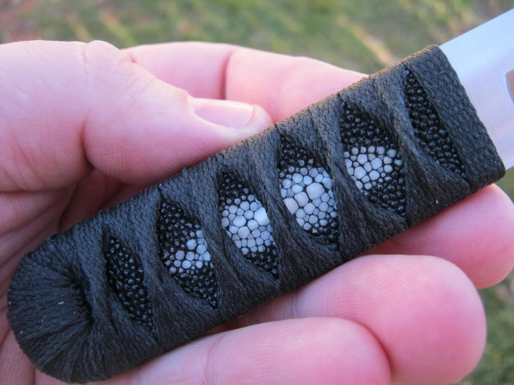

Here is a recent re-do of a tsuka on a J.D. Smith tanto with damascus blade. The handle artisan is Joshua Marlan of Mills River, NC. He does exactly what I want, and that is important for the knifemaker, the handle artisan and the collector to know, all in equality. It requires that all involved by educated as to what is available, what is historical and what is desired. I wanted premium samegawa, and a pleasing re-wrap, and the wooden core was cracked, so this required a complete re-do.....Josh's skill and prices are in concert in such a way that I have never seen a tsuka maki(handle wrapping) practitioner at this level this affordable before.
Dr. David Darom has a photograph taken by Eric Eggly of Point7 of the original handle configuration completed by Christian Griesi....the samegawa was not nearly as pretty....and see the attractive curve moving from the front of the handle towards the butt? That is not easy to do cleanly, it takes a lot of work. The diamond "windows" to the samegawa formed in the braiding should be consistent and crisp....Josh did a solid job of this, I have seen not as good on handle work costing in the thousands.

This first pic shows the disaster of choosing the wrong person to work on your handles....while told this was a full wrap of samegawa, the "artist" used panels and cut it with a dremel or similar to simulate the "seam" that is desirable in Japanese handle wrapping(this seam is the "money shot" showing without question that it is a full wrap....right! The handle core was also too long by 1/2"
Here is the handle completed:
Here is my crappy phone pic of the complete knife:

The stingray is untreated and acts like rawhide. You dampen it to make it pliable and when dry it is very hard and makes for an extremely secure handle. Having the seam on the side supports the seam in the two halves of the wood core. It isn't easy to get that seam in the samegawa to be perfect and requires a lot of patience to not rush the drying of the ray skin lest it shrink back and leave the seam open.
That is a beautiful wrap STeven. The waisted handle is very graceful and of perfect proportions. Any idea what he uses for hishigame?

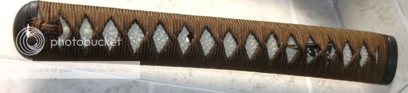

Greetings all and thank you Steven for the praise, it is much appreciated :)
I use folded paper for hishigami.
I often apply a full wrap of samegawa with the seam overlapped and offset, hidden under the ito on the Ha side for the main purpose of strength and support as was mentioned earlier in this thread. this method is much like skiving and overlapping leather on a knife or Euro sword grip. it's like 10 grit sandpaper (if there is such a thing), my fingerprints are almost gone from working with this skin for so long, lol
I have also placed the seam down the center of the Ura side(faces body when worn in the Obi) which is historically seen on most antique examples, but only when requested by the client.
the folds of the ito (wrapping cord) are supposed to alternate as they go because this way it is less likely to unravel easily if the Kashira (end cap) were to come off in a battle situation. unless you were in a life or death fight with your sword or Tanto, this alternating method is really just done these days for aesthetics and for the sake of a traditionally correct tsukamaki which I personally prefer.
here is a closer shot of a Katana Tsuka wrapped in silk ito over a full wrap of samegawa. you can see the ito alternating directions down the length.
Thank you,
-Josh
