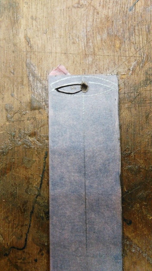

I'm still learning but I did this with a jewelers saw.
It's way faster the drilling and filing.
A tough stainless steel a bit over 1/8" with Hercules #2
