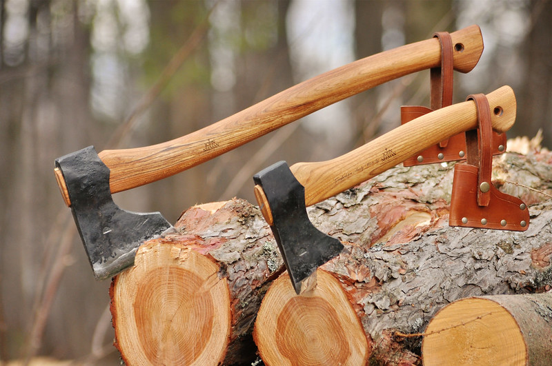

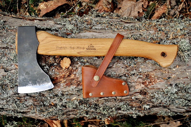

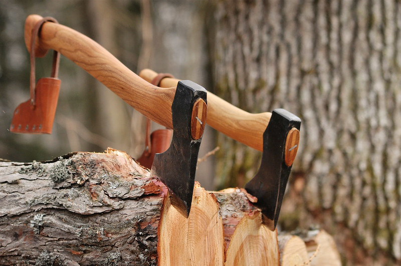

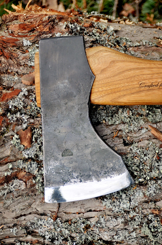

1. Northerner Hatchet.
Overall length: 16".
Axe head: 6.8".
Blade width: 3.9"
Overall weight: 2.0 lbs.
We have made this hatchet to be more universal, as union between splitting and chopping hatchet.

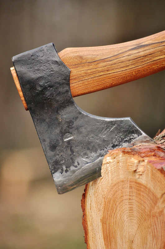

2. Northerner forest axe.
Axe head: 6.4”
Overall length: 26”
Blade width: 5”
Overall weight: 3.5 lbs.

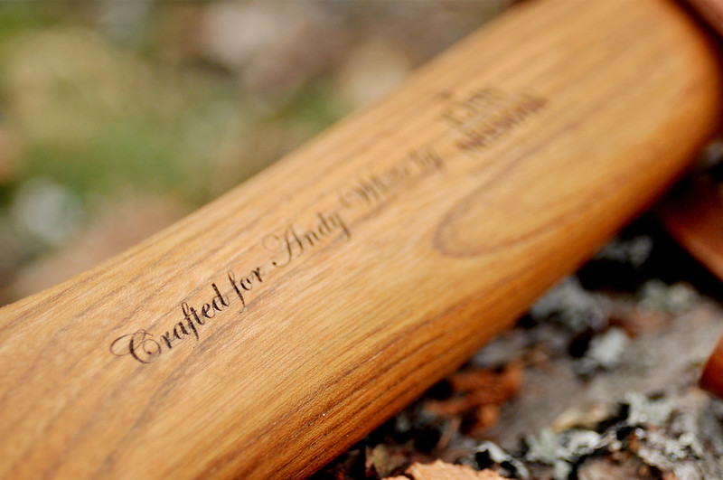

Both axes has laminated steel blades. L6 for the cutting edge. HRC 59-60. Elm wood handles. Saddle tan leather blade guards.
L6 is the toughest steel i've ever used.
nice looking slim line choppers.
beautiful work
buzz
I love the shape of that axe head, I will be very happy to get my axes and I will be bringing them to Blade for all that want to see them.
Nice work! Both will surely make a great user in the wood. The headshape on both is great really nice.

Elm looks good (I beleive you Bearhunter) and are very strong wood for the handles. We could use hickory as it has better strength properties, but it would not be any more our local and traditional heritage of tool making.
Seeking the strongest wood for tool handles our ancestors found elm tree to be the best choice hundreds of years ago.
