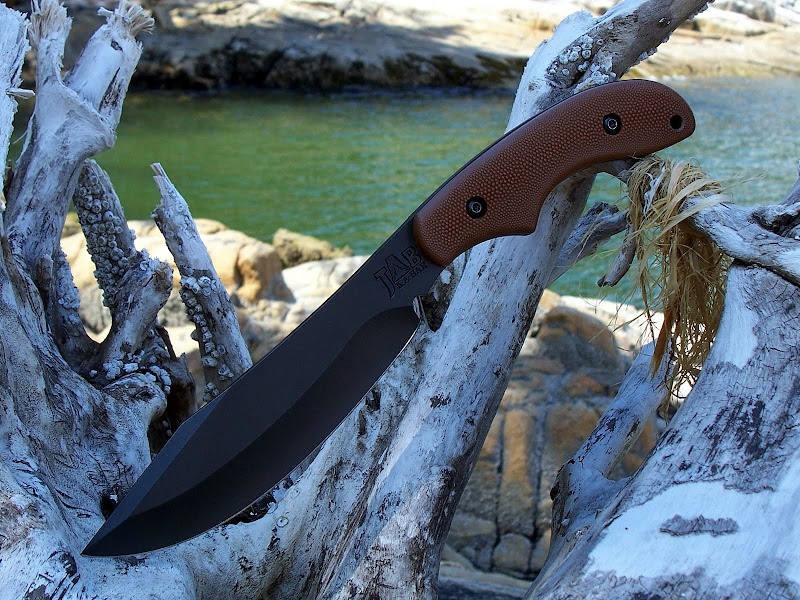

This knife is manufactured by Ka-Bar in the USA. The black coated blade is 0.25" thick, 7 1/8" long from tip to handle panel, 1 5/8 " at the widest point and made out of 1095 Cro-Van steel (same as the Becker line) at HRC 56-58. The grind is almost like a saber grind, except this primary bevel is hollow grind (not flat). The first third of the blade has an unsharpened false edge on the spine and there is a choil area right in front of the handle. The handle itself is very nicely shaped and proportioned, has a palm swell and the Zytel scales have a texture not unlike sharkskin.
I find the handle very comfortable in a variety of grips. The knife has a weight forward balance and the shape reminds me of a bolo with a clip point and a nicely curving, useful belly.
Actually, I find the name "Potbelly" fitting... Right now this chopper comes with the small companion knife, called “Piggyback”. This little blade and the sheath is made in China.
The nylon/cordura sheath has three separate compartments, one for the main blade (with a plastic inner sheath), one for the previously mentioned small skinner knife (with a protective steel strip) and the third is a fair sized accessory/storage pouch, which contains an 8' long “Adventure cord” (basically an orange shoelace...).
The back of the sheath has a lot of MOLLE attachment points and the sheath is also belt mountable at different heights, it has a couple of grommets for lashing at the top and the bottom, as well.

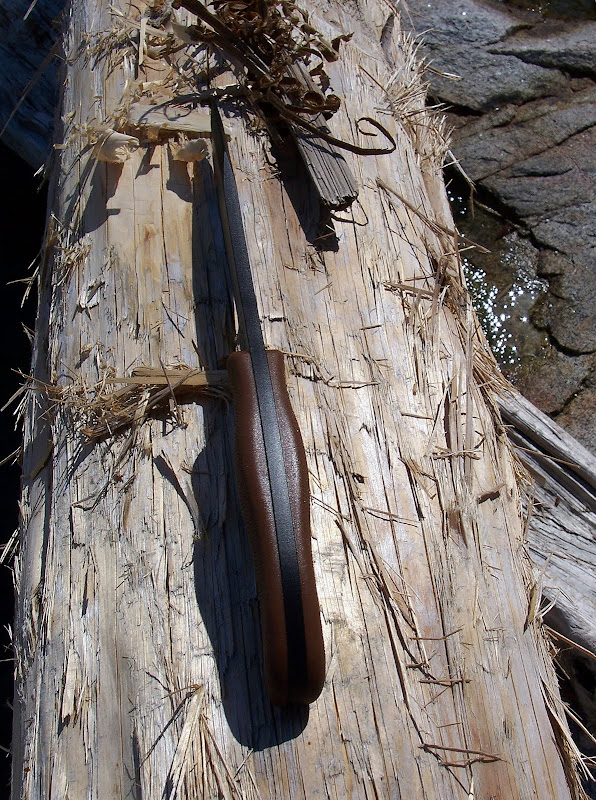

I took the Potbelly along for some day trips, a 5 day trip and had the opportunity to give it a little workout. Considering the size and weight of the knife, it did pretty good at making feather-sticks and some other, finer whittling.

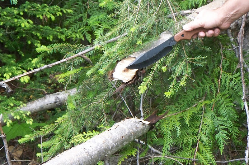

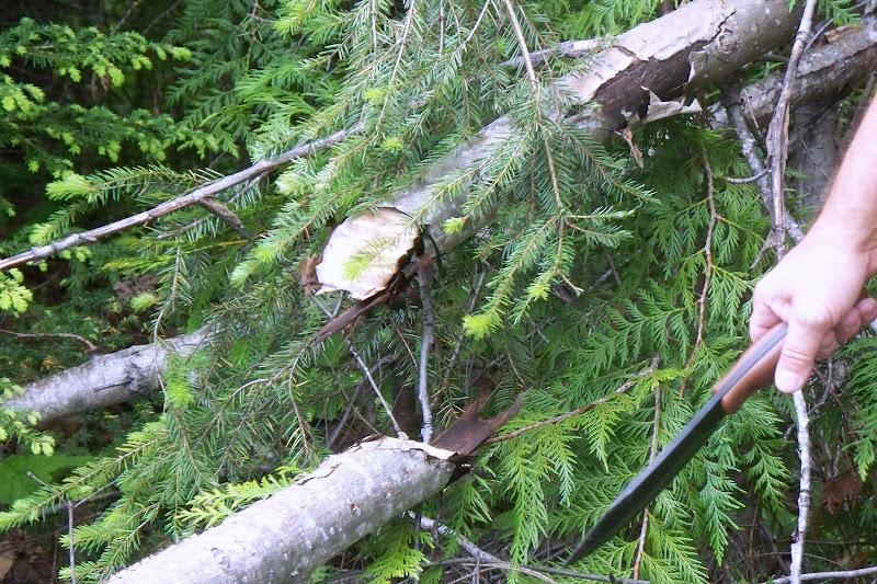

This blade really shines at chopping (which is not surprising).
Just have a look at the depth of that first strike...
Takes out big chunks of woodchips effortlessly and safely. Thanks to the shape and texture of the handle I could do this even without a lanyard. Although, I recommend the use of a lanyard, especially for extended chopping (hand fatigue, over time will weaken our grip).

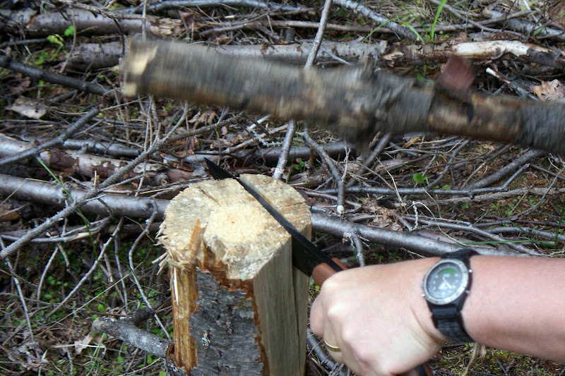

The Potbelly does well for batoning, despite of the blade geometry, which in my opinion is not ideal for this purpose.
The fruits of my batoning...
Note the knots in the wood, batoned right through... No problem!

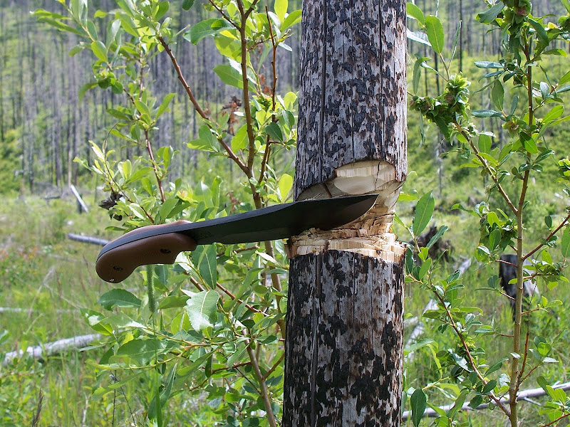

Some more chopping in fire hardened wood...
This standing, dead and burned tree was about 4” in diameter and 25-26 feet tall.
This area was devastated by forest fires seven years ago.
The knife had no damage, the blade had no nicks, chips of any sort, the edge was still sharp, the handle scales did not come loose. The only visible sign of use, was the wear in the black coat of the blade.
