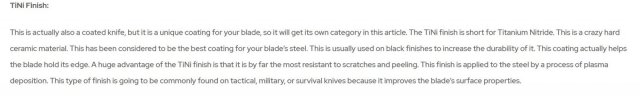

Very interesting. That makes sense to me too. Every single one of my TiNi drill bits are gold colored. It looks like the knife industry needs to set a standard as the marketing is ALL over the place.
From BladeOps (claims TiNi is Titanium Nitride).

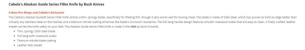

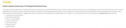

From Cabela's Alaskan Guide Buck knives (marketing claims it is a TiNi coating).

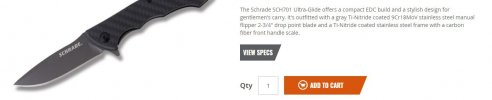

A Schrade claiming Ti-Nitride.

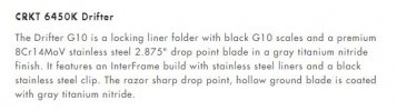

A CRKT claiming gray Titanium Nitride.

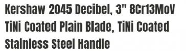

A Kershaw that claims TiNi and then calls it Titanium Carbo-Nitride later.

Unlike myself, the marketing guys are not chemistry majors. Most of them wouldn’t know BG-42 from a B-17.
