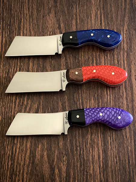

I've used it and like it very much. Works easy and polishes up nice. Some have been for custom orders and others have sold on Face Book in just a few minutes.
Hey guys...thanx for sharing the pics. Beautiful knives! Also like how you added wood on the handle Lucius.
Got my order in about a week ago of different colors, including the orange one both of you made.
