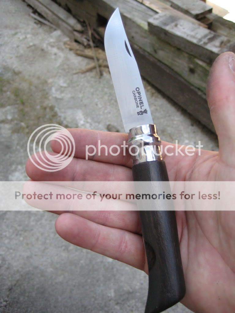

Hi guys!
Some time ago, I decided to make my fist modded Opinel. I found a couple of them in local weapon store, which doors are now closed forever.
These three brandnew I got there
I always liked the blades on Opinels. But their handles were terrible to carry in pocket. I´ve seen already some modifications on Opis. I chose one the #8 for the mod.

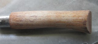

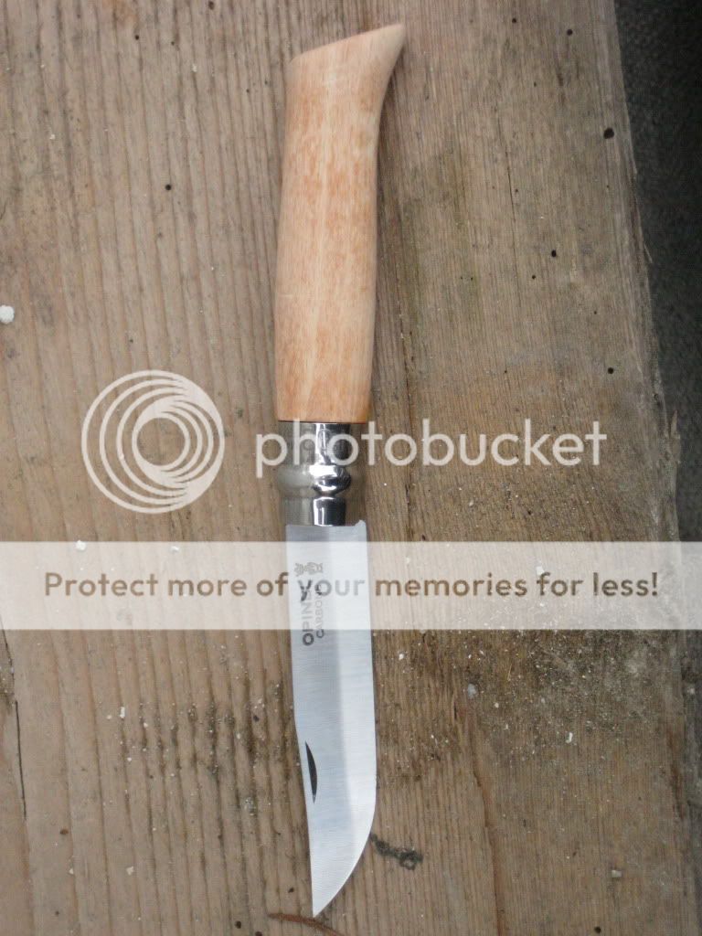

First I took off the end of the handle and removed the varnish. I rounded all the edges and polished the wood with sandpaper (320 - 600 - steelwhool - polishing at the Dremel)
So it had the same size of the #7 but without that "butt".
I was inspired by the easier opening, so I removed a little of the handle material at that point. Took on a new varnish in a darker colour. And did the varnish treatment about three times.

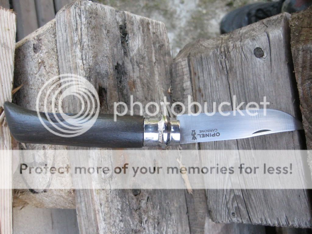

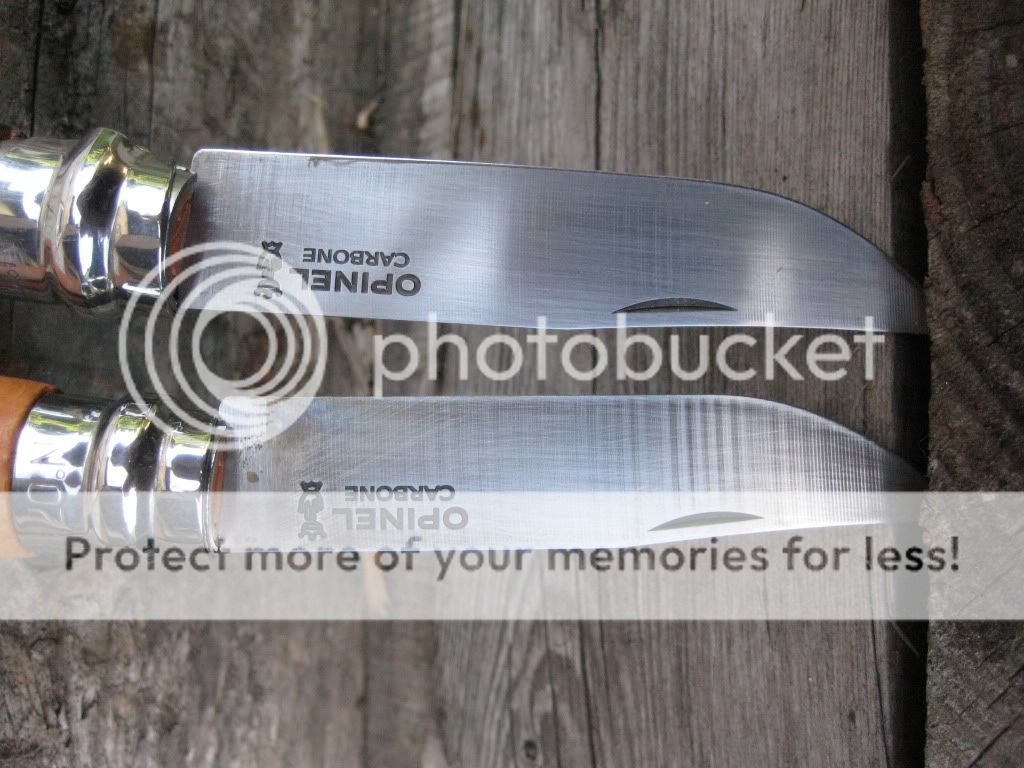

The I wanted to do somekind of polishing the blade - the same setup like I did with the handle. But it didn´t really work - so here´s the failure of the bladepolishing-try :( It seems, I don´t have the right tools for doing that job.

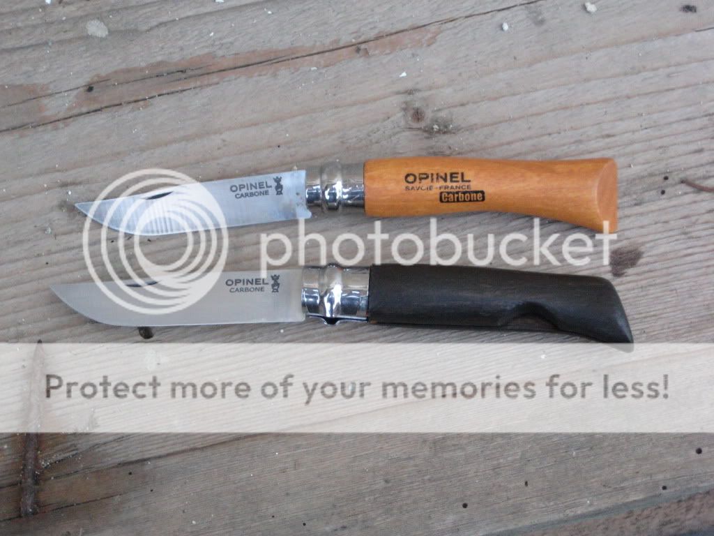

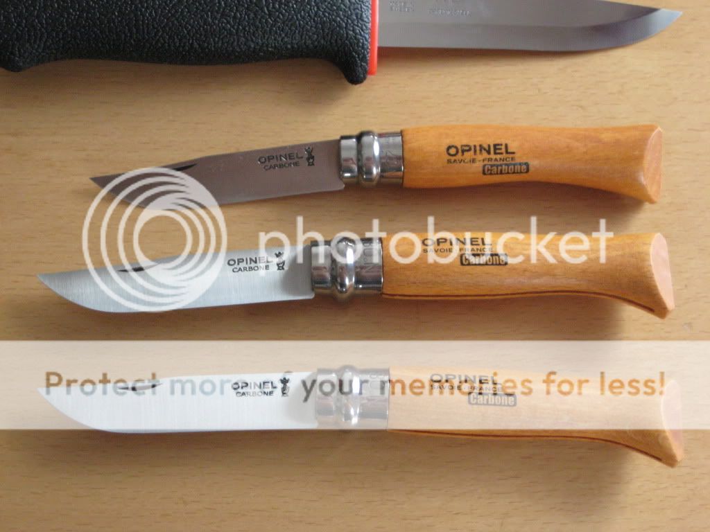

Size comparison to the #7

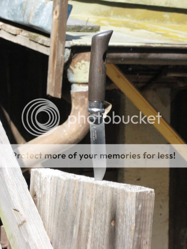

Here´s the finished Opinel #8 modification.
What do you guys think? Please give me some feedback (positive or negative opinions are wellcome, for sure)
Feel free to post your own Opinel modification here. :)
I´m looking forward seeing more of yours.
Kind regards
Andi

Andi it takes a lot of time but the end results are so worth it. If I was you I'd start the blade polish with 220 then when you can start to see a slight reflection go to 400 then after the reflection gets clearer go 600 same process wait for reflection to be clearer then before, then I move to 1500 and finish it off with a wax. BTW the opie looks great with the cut out and vanish. :thumbup:

I removed the varnish by hand and cut off the end. The whole profile was made a little slimmer. But not much, so I didn´t do much work on the handle itself. The most work was rounding all the corners that came by cutting and carving. I thought the paint would be a little lighter and not that dark, but I think it looks nice and pretty traditional.

Hummpa, looks great. I like the color you got and really like the shape you put on the end. Very interesting. Two things... First, I prefer more of a drop point and put the knife in a vice and work the tip down with a file. Taking off the flip at the end of the clip point also allows me to take the butt end of the handle down further. Second, regarding the polishing, I start with 220 grit paper going from hinge to tip. Keep applying water to keep the blade cool, change paper when it loads up with steel and keep working until the original grind marks (oriented spine to edge) are COMPLETELY gone.
Once this is done, work your way up through progressively higher grits working at alternating right angles. First spine to edge. Then hinge to tip. Don't change directions until the sanding marks from the previous direction are entirely gone. Work your way to 2000 grit and then rubbing compound and then polishing cream and finally a strop. It's a labor of love, but it's also functional. The blade slices better with the grind marks gone.

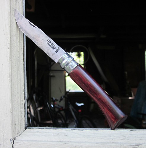

Humpa, very well done :thumbup: I really like your EO notch and the dark color is very pleasing:)
I know you have seen my Opie before but here is a older pic of it in brighter light...
Hi sitflyer!
I really like the color of that handle. The bladeshape is also pretty nice :)

Better lighting on blue is always good. :)

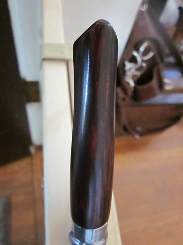

Do you (or anyone else) have an explanation for the small, often vertical areas of wood that refuse to take varnish or stain? I have a couple spots very much like those more clearly seen in sitflyer's handle above.
Pinnah, thanks for the note regarding not sanding with higher grits. I wouldn't have thought of that, and in fact didn't. I used 0000 steel wool in between (failed) stain attempts before going with the Polyshades all-in-one.

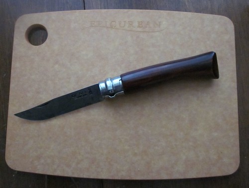

@Pertinoux: that dark handle looks stunning!!! What kind of wood is that and what did you use to stain/finish it?
Also, I'm not smaat (as we say here) enough either, which is why I had to go to wood finishing shop where the guy snickered a bit and then hit me with a noob stick. Good for the spirit to be corrected every once in a while! Finished with 220, the beech drank up with water based dye but it does raise/emphasize the grain quite a bit. I hope to try another one soon with oil based stain, which I totally gave up on with earlier attempts. My understanding (noob, remember) is that super hard woods like beech do better with water based dyes but oil based stains raise the grain less. Still learning, which is better than coasting, I guess...
Thanks! I had to search to find where I'd posted about this knife before, and found my message in the "What Traditional Knife Are You Totin' Today?" thread. Go figure. I've reposted it below.
This is a standard Opinel No.7 in carbon, so -- is that beech?
I'm now wondering if I sanded the handle too much, instead of too little? But my impression at the time, which the in-progress pictures seem to still support, is that the original finish goes deep into the wood along some of the grain lines.
Unlike the orange-y finish on the carbon Opinels, I actually like the natural look of the stainless steel versions. So, despite what I wrote previously (below), I'm now leaning towards leaving the No.8 (Gardener's) as is, and let it rustic-ize over time and use.
~ P.
Short answer: MinWax PolyShades, Bombay Mahogany Satin-- "Stain and Polyurethane in 1 Step."
