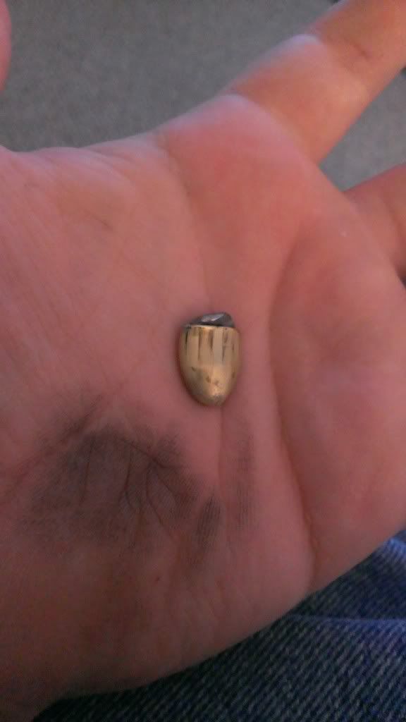

So today I purchased a Kel Tec P11 used at a local gun store. While I was pulling back the slide to load a round the slide slipped and the gun went off. Now I don't know anything about Kel-Tec but I'm pretty sure that shouldn't happen.
Slam fires are no good. You might try checking for any debris around the striker or if the striker is stuck in an extended state. Personally, I would go to a safe environment and attempt to recreate the failure on video; then, consult with Kel Tec if necessary. After checking the mechanics of the pistol over for blatant issues.

Well, went to a pistol range too try and recreate the incident with no success. I let the slide slam forward, and I also had the trigger pulled back while letting the slide slam forward. However, what did happen next was that the trigger would not reset. Which is when I took it back to the gun store since it was only five minutes away, he took a look at it and discovered a piece brass in it. He believed that it was there from the original owner and it just worked its way into the action. Nice people that own that store, he told me that if their is any more issues to bring it back and he'll make it right with either a refund, exchange, or repairing it. So I'll probably go back to the range later this week to give it another run through. Also I found the slug from the slam fire and a little reminder from some powder burns of how close I came to losing a big chunk from my hand.

I'm fairly certain that if a weak firing pin spring was the case I should've been able to recreate it. I'm probably going to have gunsmith or my buddy who is a hobby gunsmith take a look at it just for peace of mind.
