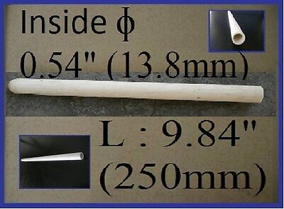

Thanks. I see plenty of the ceramic beaded 'kiln' K types at a reasonable price, cannot find the ceramic protective sheaths when I look around except for the odd one at 2 or 3 x the price of the thermocouple. I'm in England, by the way. I have myself the PID and I use it for my curing oven and other things, but for now I'll just be reading out forge temps on the digital meter. Saying all this the thing hasn't even been fully set up yet.

Do you have the ceramic protective sheath for your sensor?
Yes, this is necessary. I can't answer the atmosphere question, though. I thought that the sheath was mainly for protecting the sensor from getting knocked around as well as helping to protect it from the flame from the burner which I would think can be significantly higher than the general forge interior temperature.
Ebay, Amazon, Omega, etc.
I appreciate that but those are on ebay.com there are none on ebay uk. My wallet is not in the mood for importing anything right now especially not with what the brexit idiots have done. Cheers!
Here's what I have in my forge:
Cheers for that. Still can't find one (sheath) over here in the UK - amazon uk has an expired listing for them and that's it.
Thermocouples can be re-welded in an argon purged plasma. We had a tool for it back in school where we used them constantly and destroyed them regularly. Also, copper leads are compatible you just need to keep the copper electrical junction to the K leads outside the forge near room temp. The connection of K to copper is itself a thermocouple and it can play with the readout if it gets hot.
The ceramic tube are great, but in a pinch you can make your own. We used kaowool wrapped in steel foil. You could do the same with refractory cement and steel foil. It should work until you find better sources.

Most of the ones on ebay and Amazon are shipped from China, so they should ship to the UK. Use the US listing and just contact the seller.
Useful to know, thanks for that, seems like I have an easy solution at a pinch! I'm already down on the cautions of using different metals for thermocouple connections, so all good there. Cheers again!
