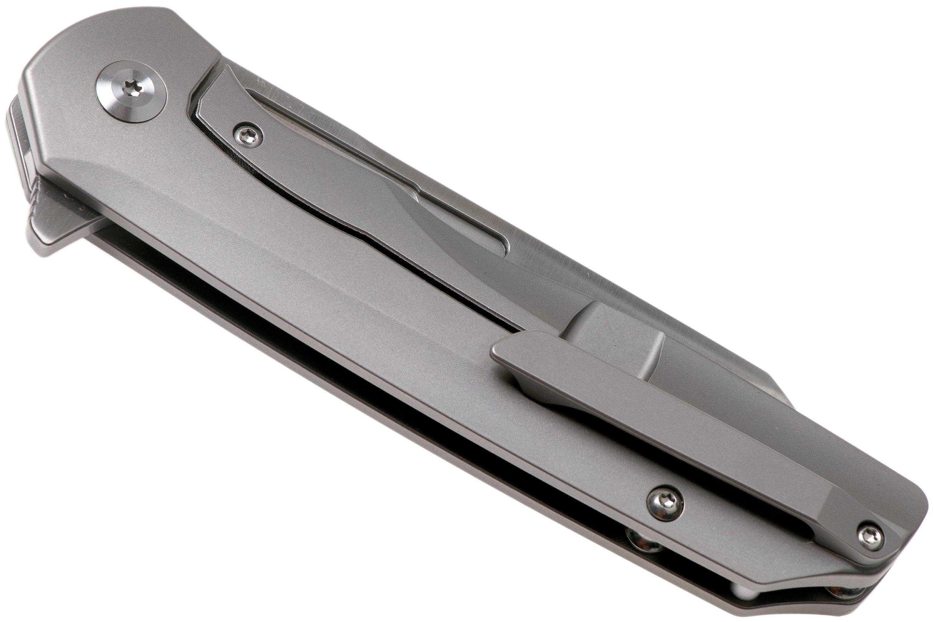

I recently purchased a Kansept Shard in plain blue satin titanium with no timascus inlays. So far, I am absolutely loving the blade in all aspects save for one: this godforsaken proprietary, milled pocket clip. It is definitely very high quality and super sturdy, but the ramping is so unbelievably steep that it is a burden and a chore to get it to clear most pocket linings without either using 2 hands or using excess force and damaging the fabric pretty quickly over time. I have tried to find some custom options for a different, more traditionally styled pocket clip (think the classic flat, swooped clip), but because it is a single screw design that sits flush in a recessed area to prevent pivoting, I have found it pretty much impossible to get anything that would be compatible.
Does anyone have any suggestions for how I could solve this problem (or recommendations for bespoke custom clips that might fit) before I take my dremel & a grinding tip & make the ramping more shallow myself? I'm hesitant to do this, but the frustration is mounting 😵‍💫😤

I had the same idea at first, actually! I thought about fashioning some sort of custom washer or finding one that is the correct diameter for the hex screw. I actually incorrectly explained the pivot-prevention method in the original post. Instead of a recessed area, there is a little nub on the bottom of the clip (close to the screw hole) that fits into a small hole on the scale. If I raise the clip off the body even by a tiny bit, I suspect the clip will wobble because the nub is very short and won't reach the receptacle 🤣

Hmmmm, yes you are correct. Breaking out the dremel is a bit rash........ bwahaha.
I suppose taking a look at some custom clips I could modify with hand/power tools would probably be the best bet. I definitely don't have the money, skill, or tools to fab one on my own......YET

Yup. That's the one. Except my clip is a lovely matte black. Truly, it is a gorgeous knife. The satin black accents look sooooo good on the soft blue anodized titanium. The clip is HANDSOME too. Very understated yet classy. I just wish it had a more shallow ramp. If you look at a side profile view, it looks akin to a skatepark halfpipe on the initial curve -your pocket lining just gets rammed straight into it instead of sliding nicely underneath.

Although, I just had the thought that I could draw up a cad file, and have it fabbed by a service like sendcutsend in grade 5 titanium 🤔
Is that a decent material for a clip, or is there a better choice?
Yes, I can see how that's a problem. It looks like the slide-on "ramp" and the slide-off "ramp" should have been reversed. It looks like there is enough material for modification. Can you get a replacement clip if something goes wrong or are you out of luck? I would stay away from the high speed rotary tool as it's easy to lose control. I would instead use files and stones. If you are careful with these you will only lose the matte black finish from the underside of the clip.
Yes, I can see how that's a problem. It looks like the side-on "ramp" and the slide-off "ramp" should have been reversed. It looks like there is enough material for modification. Can you get a replacement clip if something goes wrong or are you out of luck? I would stay away from the high speed rotary tool as it's easy to lose control. I would instead use files and stones. If you are careful with these you will only lose the matte black finish from the underside of the clip.
You can actually get a replacement! Just checked. OK, so grinding it down is actually looking safer at this point since I can just replace it if I f*ck up! You are right, I was worried about control and precision issues with a rotary tool as well. Will probably use a non-powered method of filing it. Also, agreed. They definitely should have reversed those ramp angles, or just made both of them rather shallow. Still struggling to understand how they OK'd this design. Makes me wonder if they even tested it at all.....
