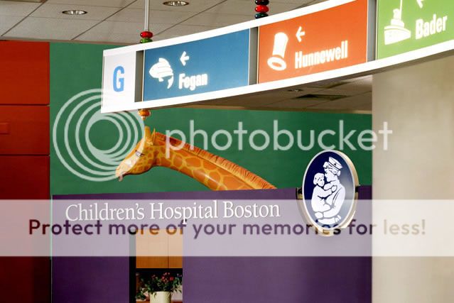

Styrofoam hard coated giraffe with West System epoxy painted with Nova color Same paint for the graphics.
