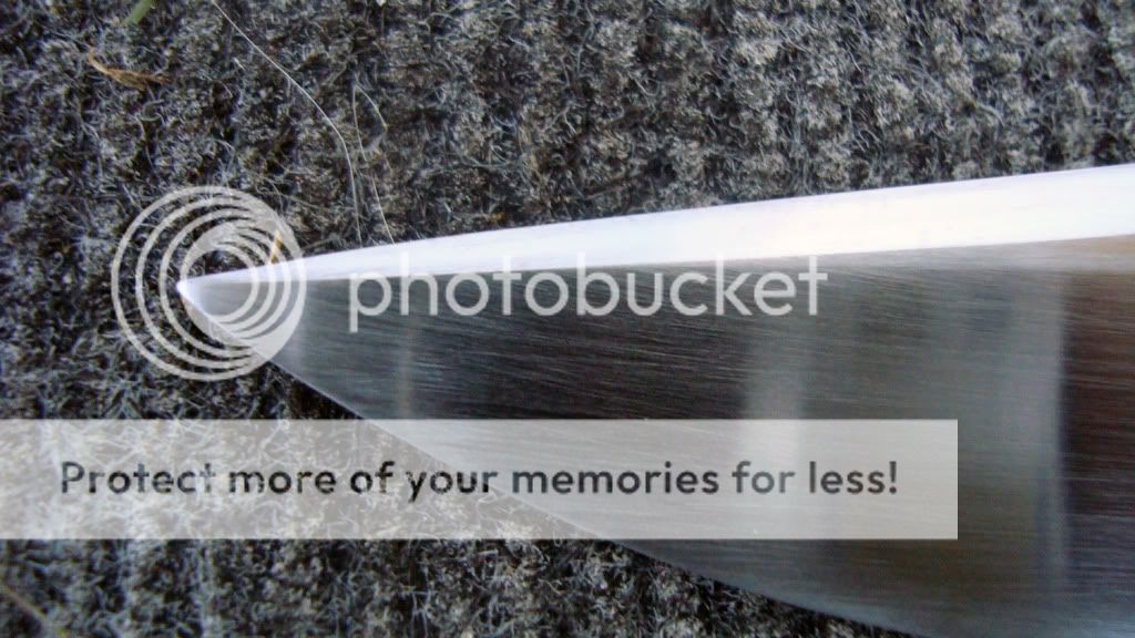

The tips are working even though I can only go to a 220 belt finish. I have one side at 400 grit and the other is almost done to 600 grit. I still have a few light scratches from the 400 to clean up before it is done, but that line keeps getting sharper.
This is the side that is almost fully sanded to 600 grit
and right at the tip the line is sharp as can be
