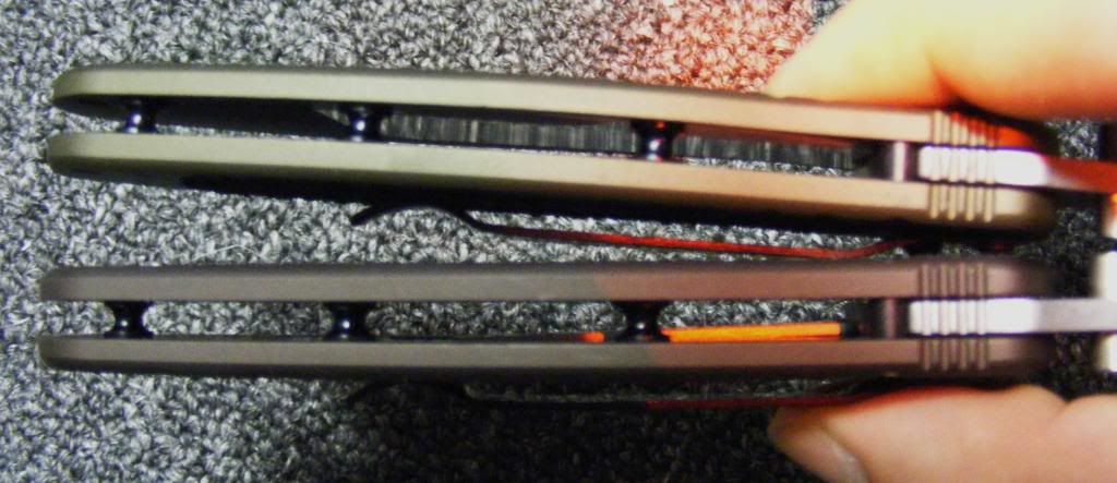

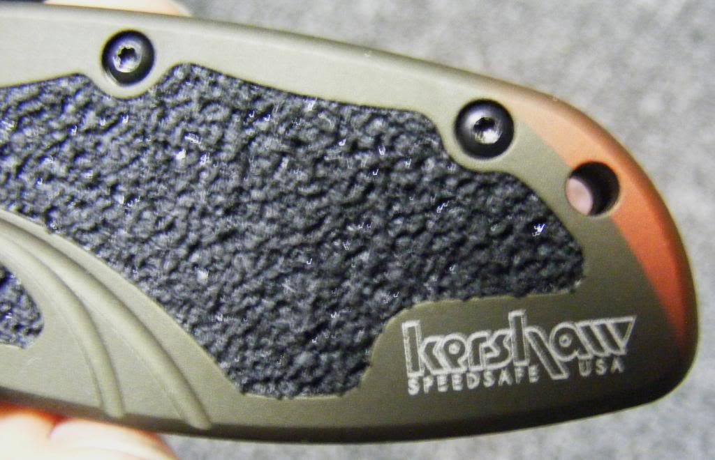

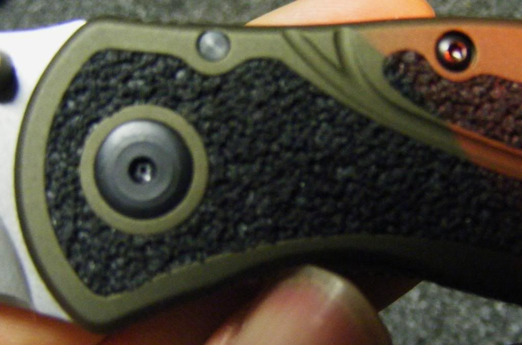

The Handle: the Blur is 4-1/2" long when closed and just under 1/2" thick, not counting the pocket clip. The handles are made of hard-anodized aluminum and have Trac-Tec inserts. Basically, Trac-Tec is like skateboard tape but not as rough. It has more of a rubbery feel than it does sandpaper.
The handles are pillar construction, and have Kershaw's nice hourglass-style spacers.
The handles are held together with three black T-6 screws, and one black T-8 screw as the blade pivot pin screw. This lets you play with the tension on the blade for better opening, but all of mine came perfect out of the box.

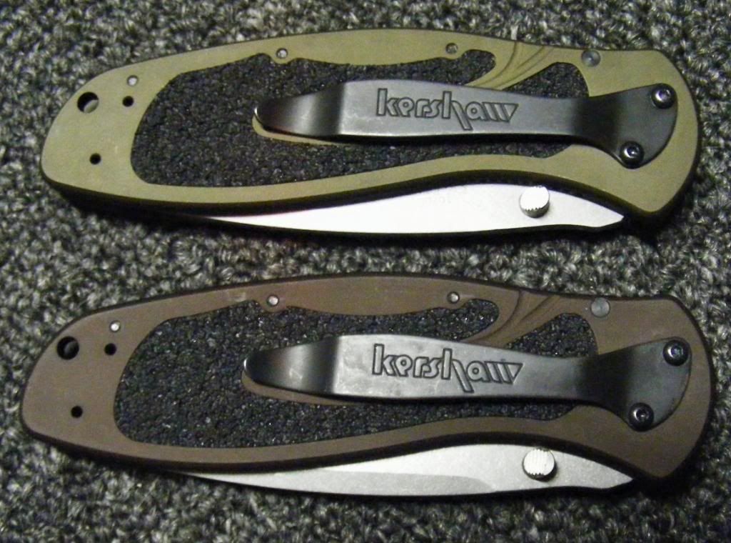

The Blurs share the same pocket clip as the Leek, and it's adjustable for tip up or tip down carry, but is right-hand only.
The clip has good tension and nice placement, although tip-down carry sits a little lower in the pocket than tip-up carry. A nice thing about the Blur is that the grippy Trac-Tec isn't underneath the pocket clip, which allows for a smooth draw from your pocket; no pants snagging or ripped pockets. The pocket clip is held on with two blackened T-6 screws.

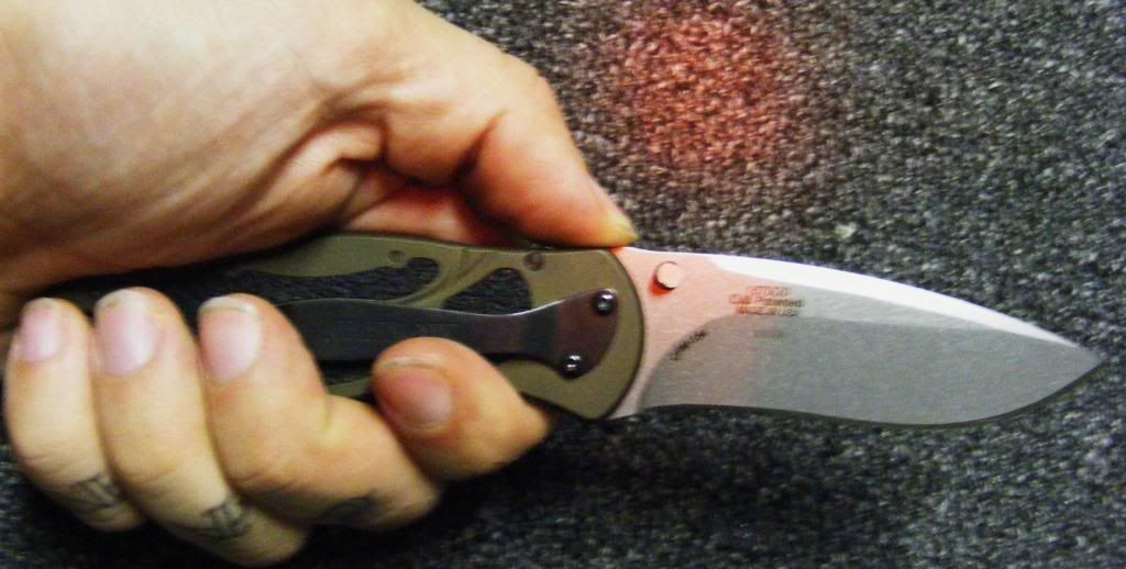

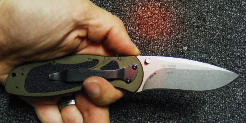

In-hand the Blur is nice cutting tool to use. It's a four-finger knife for me, and I think it would be perfect if it had perhaps 1/2" more of handle space.

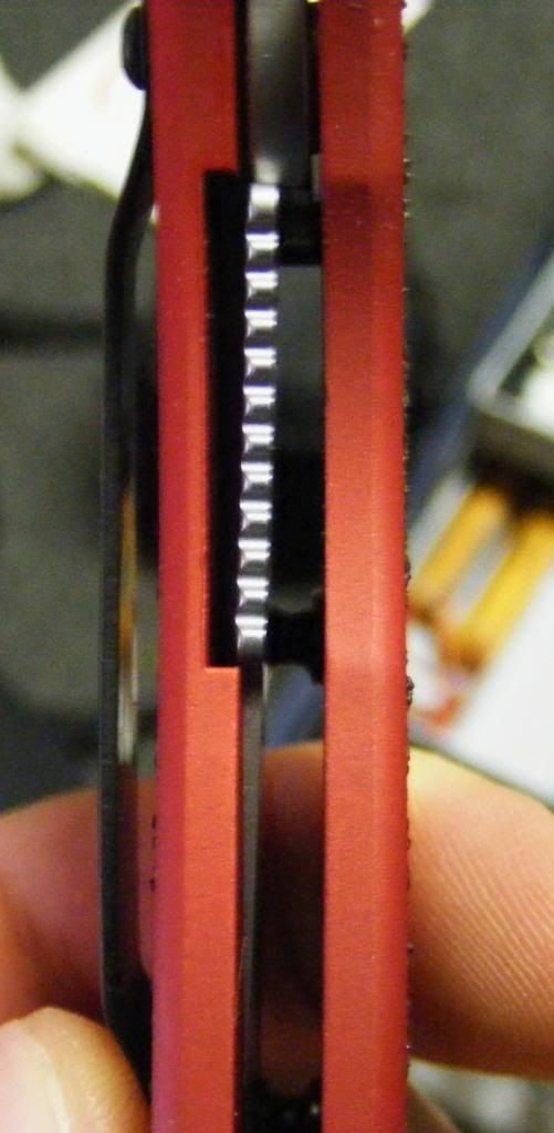

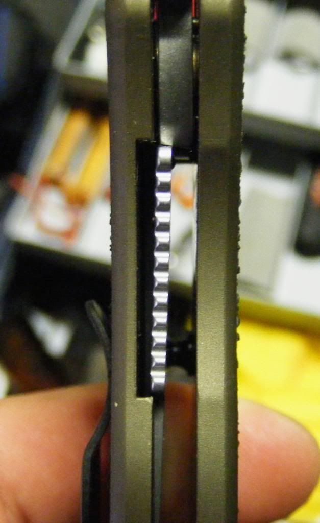

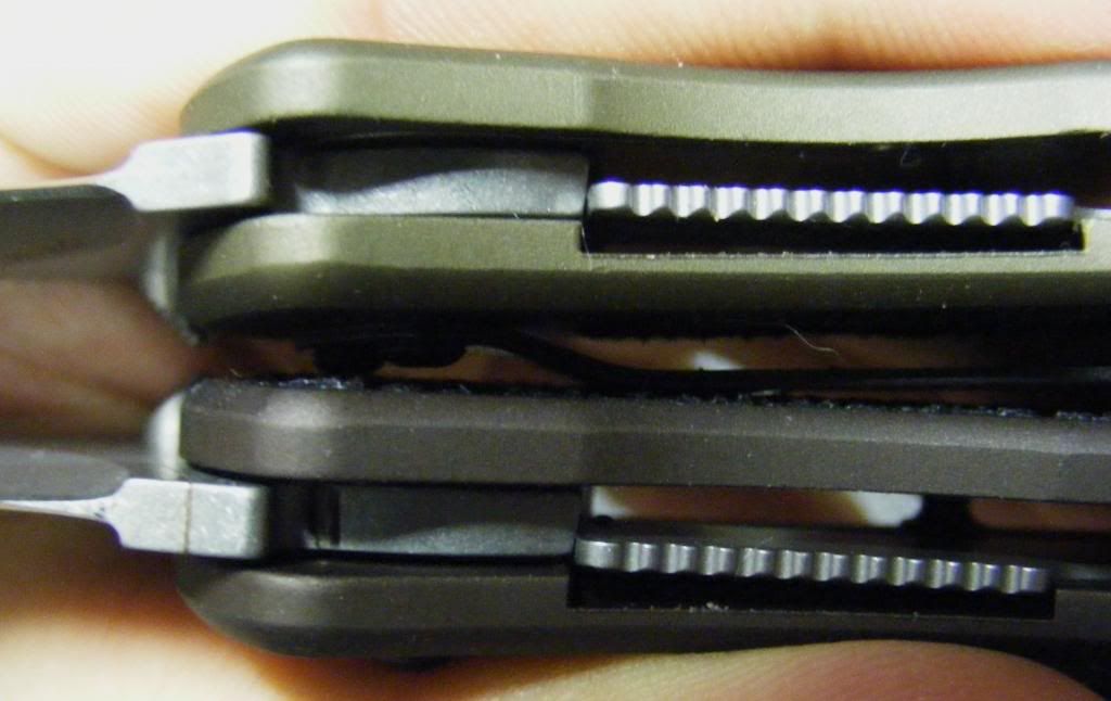

While using the Blur, I found the jimping formed by the handle and blade spine to be adequate, but I'd like to see it longer and a little deeper. It's good, but not great.
The Blur is easy to open and close, and is one of those "melts in your hand" knives. The comfort level is high with this model.

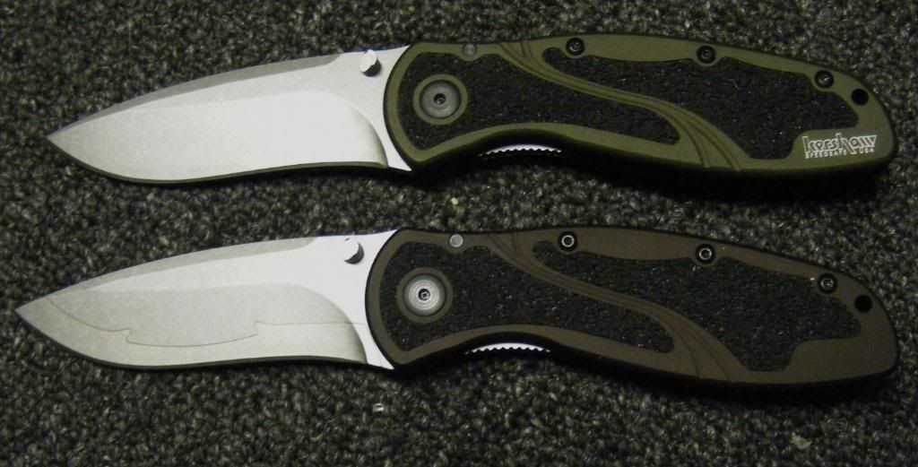

The Blade: The blur's blade is made of Sandvik 14C26N stainless steel at 58-60 on the Rockwell scale. It's 3-3/8" long and 1/8" thick with a very shallow hollow grind. The finish is bead-blasted.
The Blur has a slight recurve shape, but I've not found it to be a problem resharpening. Mine all came paper-slicing sharp right out of the box.
The Blurs all have Kershaw's ramped thumb studs, and there's one on each side of the blade. Just put your thumb on the stud and push; there's no need for a pressure build-up and flick like you'd use on a manual linerlock. Opening is fast and smooth, as the Blur's blade rides on phosphor bronze bushings (one on each side of the blade).
