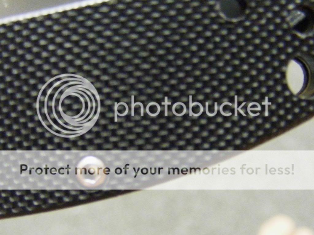

The Chill has black G-10 handle scales, and I find that they're textured to look like carbon fiber. Maybe that's just me. They feel great, just perfect in roughness and pattern.

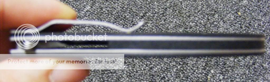

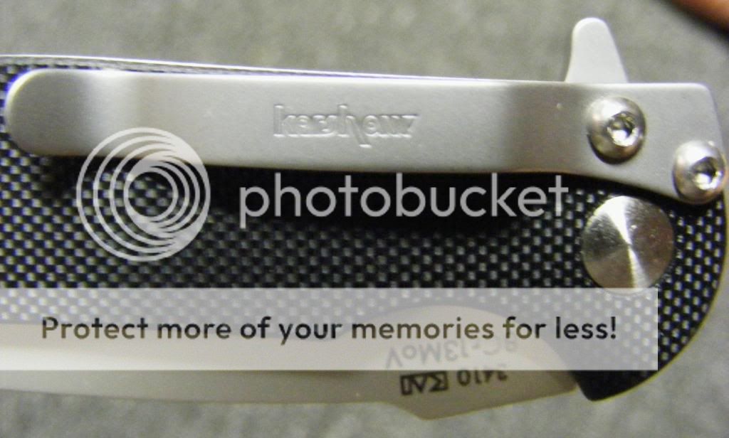

The Chill has a reversible pocket clip, right-hand only (tip up or down). The clip is brushed stainless steel with Kershaw's logo stamped in. It's adjustable via the same size hex screws as the handle screws.
The clip has nice tension in the pocket and placement is good, but I've found that in tip-down position, the spot on the clip that touches your pocket also touches the very first handle screw. Maybe this is intentional, I don't know. It doesn't affect performance in any way, but it's something I noticed.

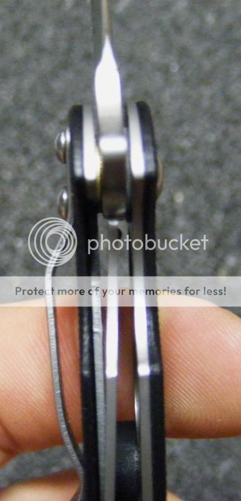

The Chill is a linerlock, and it locks up very solid. The liner isn't jimped, but it doesn't need to be. The liners are each 1/16" thick.
The blade rides on two bushings; the one on the locking side is phosphor bronze while the one on the non-locking side is white nylon. Opening is easily accomplished with the flipper, and requires no wrist flip.

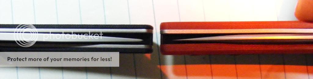

It's thinner than the Skyline, despite the Chill having two stainless steel liners and the Skyline only having one. (My red Skyline is shown to tell the difference immediately.)

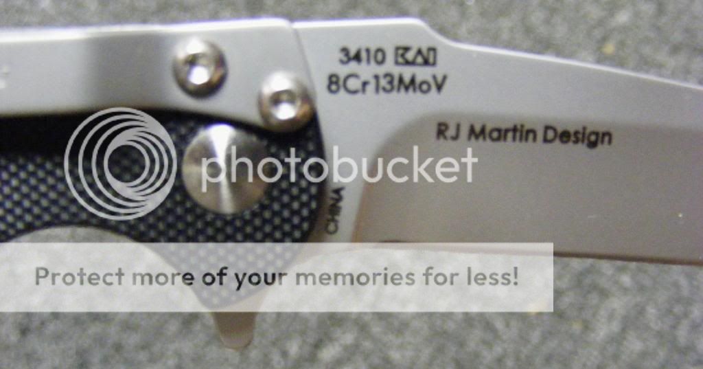

The Blade: The Chill has a thin, narrow blade which is perfect for slicing. It's 3-3/8" long with a 3-1/4" cutting edge, and it's flat ground from about 3/4 way up the blade. The blade is just under 1/8" thick and has a brushed finish.
Blade steel is 8Cr13MoV, and mine came extremely sharp right out of the box. Kershaw heat treats their 8Cr13MoV to 58-60 on the Rockwell scale, and I've found that this makes it slightly better than other brands using this steel.
