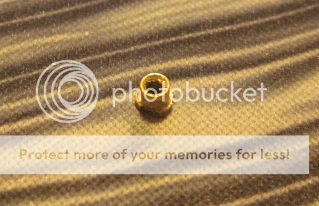

One of the EDC knives that replaced the Skyline for me was the Leatherman c33 (yes, I know, it has the same pocket clip issues as the 1760). It was a small, lightweight cheap (~$20) folding knife that I could beat on without worrying about damage. The c33 has since been replaced my many other EDC knives that I much prefer (SOG Visionary I and II, Benchmade Mini Griptilian, Browning Flash 120BL), but one feature of the Leatherman c33 that I have found great value in is the pocket clip screw lugs.

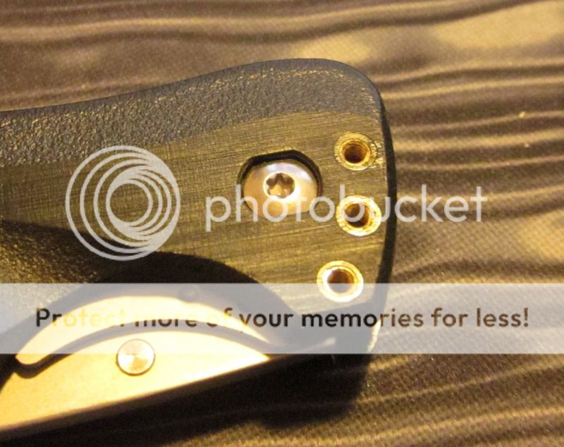

There are three of these in each Leatherman Crater 33 series and Expanse 33 series knife and are removable. I tried to modify my Leatherman c33 to have the pocket clip on the left-side tip-up end, but drilling the three holes for it was a bit of a nightmare for a novice like myself.
Luckily, the Skyline only has two pocket clip screw holes, making the whole (hole... *groan*) drilling process slightly less complicated. I decided to utilize the lugs from the Leatherman knife and make my Kershaw a left-carry knife. The results are as shown:
As I stated earlier, the drilling process was only slightly less complicated but still enough of a challenge for myself to mess it up once (ruining the best spot to put the clip). The spot that I did decide to put it was a little too close to the rearmost handle screw, and I consequently had to grind the end of the clip to accommodate it. The screws you see in the picture are also taken from the Leatherman c33 due to the fact that the Skyline pocket clip screws are too large for the threads of the lugs. They don't match perfectly with the other screws, but it's not bad.

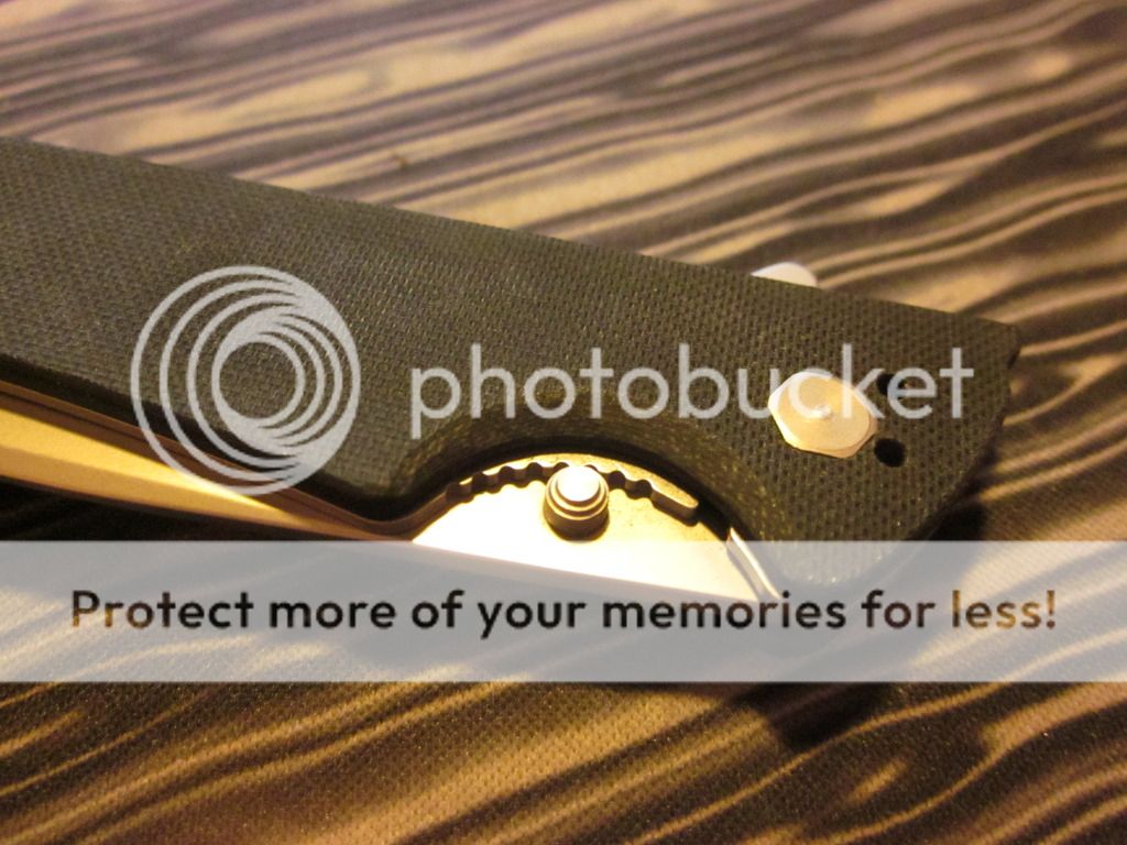

The other issue was remedied quite simply by taking a Dremel to the finger choil area on the left-side scale and carving it out a bit to allow access to the left-side thumb stud:
