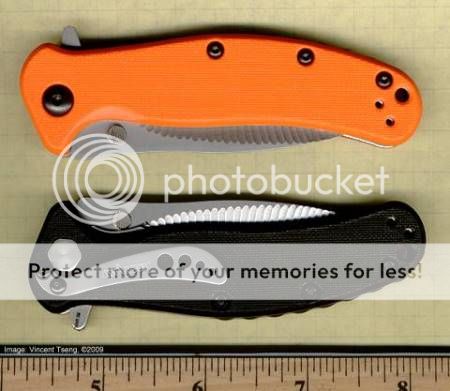

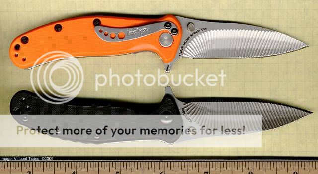

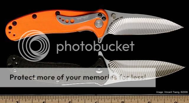

Those were more "artsy" photos above - here are more clinical ones -
Both these Zings arrived with their pivot screws rather tight - so I had a difficult time opening them fully with the flipper. Using a Torx T-9 I found the screws very tight - but this also meant I could adjust the pivot very finely.
Adjusted so that the blade would just fall under gravity when unlocked - but no hint of any wobble/play in the blade when open - these then will literally fly open with a snap when flipped almost effortlessly - the action (once adjusted) can be quite astounding.
The action of these Zings are noticably snappier when compared to the already excellent JunkYard Dogs and Groove. Very comparable to the Kerhsaw RAM which I was very impressed with.

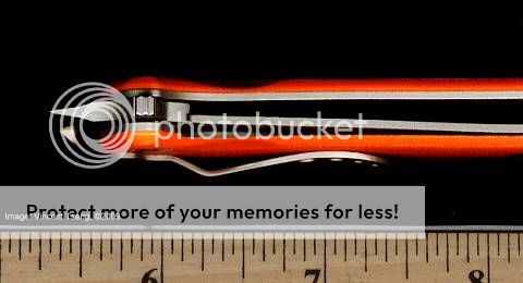

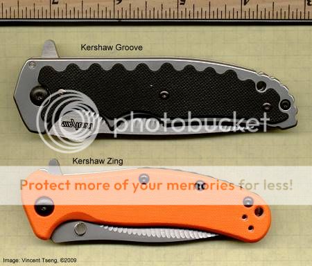

Closed -
Notice the flippers - because of the swell in the handle toward the blade - these are not quite as protruding as on the Groove.

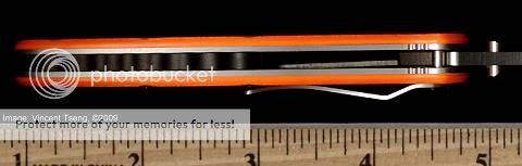

The locks on the Zings were very well done - the liner looks thick and both samples have the liner just fully engaged - very nice -
The back of the handle has a nice touch in the spacer has nice ridge bumps.

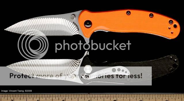

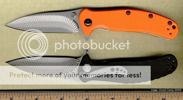

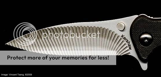

Of course the blades look stunning to me - almost like radiating pattern and I like the way the blade is stepped hollow ground - which helps in emphasizing the radiating pattern.
The groove pattern doesn't seem to get in the way when cutting through things - going through corrugated cardboard for example - I can actually feel the groove pattern - but it seems to retard the blade's pull through, so the blade actually managed (for me) to stay in the cardboard longer - therefore giving a deeper cut - interesting.......

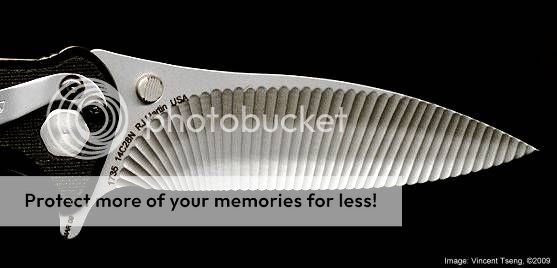

The Zing uses the new Sandvik 14C28N stainless steel which I think may be a Kershaw exclusive(?) - this is said to be an improvement over the already highly regarded 13C26.
