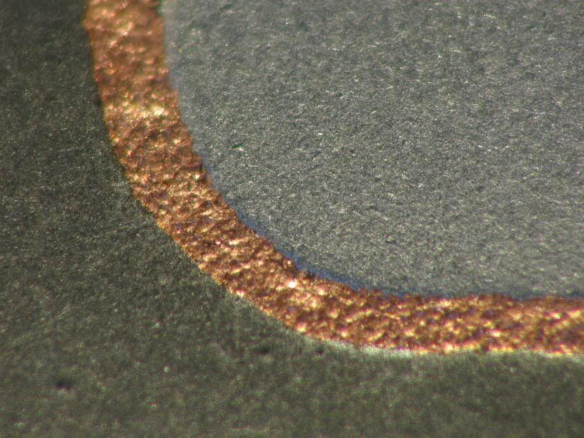

The third metal is copper which they use to create the weld. It is very very thin (a good thing), and creates a weld that, in my experience, is every bit as tough as a standard blade.

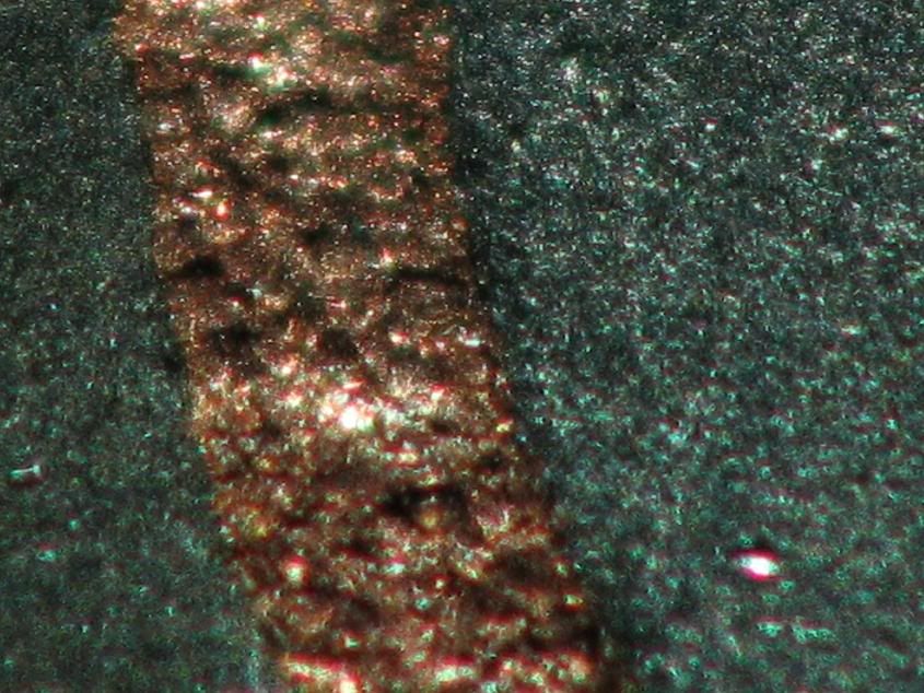

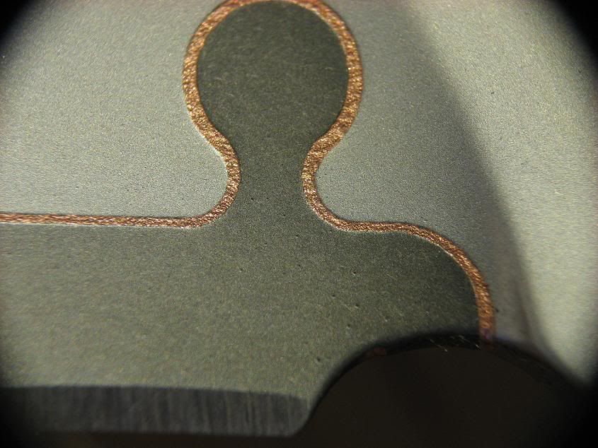

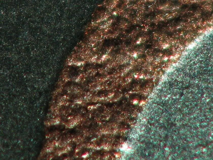

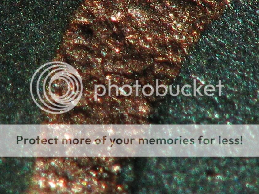

Here's some spiffy shots of my CB JYD II (IMO one of the toughest folders out there).
Zooming in.
x60 magnification.

I think they braze it. A brazed joint is very strong. In the text books, they tell you ia brazed joint is stronger than the joined materials. There are brazing compounds specifically designed for stainless steels. Many of them are combinations of copper and silver, so they end up looking yellow or like copper.
Don't worry about the strength. You won't break it at the joint.

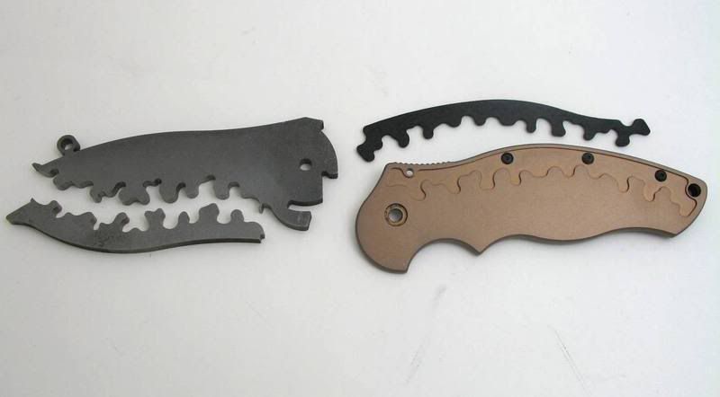

There probably isn't much chance of the pieces coming apart under normal use. It would be interesting thosugh for someone with to try to break it apart and see if they could.
If you do, wear your safety goggles!
I like the way the two sections lock in place like pieces of a jigsaw puzzle.
Thanks for the extra close-up views. Certainly bolsters my faith in the overall strength of the blade. Not that I doubted the blade's strength. It's a Kershaw.:D

Are the 2 pieces of each blade joined and then brazed or is it done in a huge billet that each blade is cut from? Id like to see a pic of what STR can do to these.. Ive asked before, but havent seen one yet.. Can someone point me in the right direction?
