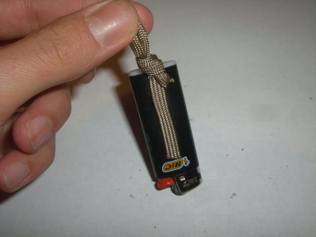

Hey all. Here’s a cool little keychain lighter I fashioned a few weeks ago during a late night moment of creativity. While I love the elegance of my County Comm stainless peanut lighter, its best suited as a backup to a regular lighter, not as a primary ignition source. As a smoker and fireworks aficionado, I wanted to have a primary lighter on my keys for days when I forget my Zippo.
This lighter has been in constant use for the last 2 weeks, and has held up very well. So well, in fact, that my friends have had me make them some as well. I figured the WSS crew would also enjoy them, so I made the following tutorial.
How To Make a Mini-Bic Keychain

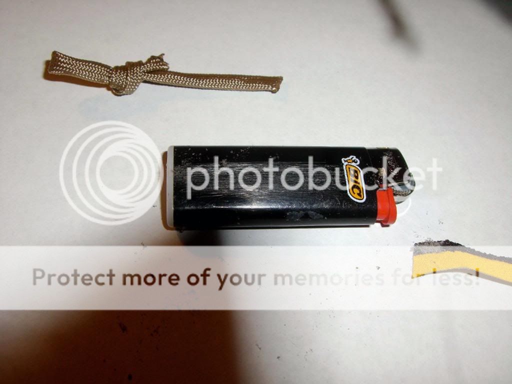

You will need: A black mini-Bic Lighter, a tube of super glue, some hollowed out paracord, silicon self-adhesive tape (I use ‘Xtreme’ brand, but any USA made variety will work) and a bit of sandpaper or file (not pictured.)
1. Tie a loop of hollowed out paracord.
2. Cut the cord to the length of the lighter, just beneath the ‘Bic’ logo.
3. Roughen up the side of the lighter with a file or sandpaper where you want to glue.
4. Apply glue to the rough patch.
5. Apply glue to paracord.
6. Press together and hold for 90 seconds- careful not to glue your fingers to the lighter!
7. Now, check if dried.
8. Once dry, it’s time to reinforce the edges with more glue, for a Murphy proof hold.
9. Once the 2nd layer of glue is dry, its time to cut an 8” piece of Silicon self-adhesive tape.
10. Now, starting from the top, wrap the lighter in 2 layers of Silicon tape. This will protect the brittle super glue from being damaged by your keys. It also looks nicer, and provides a comfortable rubberized grip. I use this stuff on everything.
11. Now, you’re done!
12. Attach to your keys and have a victory smoke.
I hope you enjoyed this little gizmo, and if anyone has any ideas on how it can be improved, please post them!
