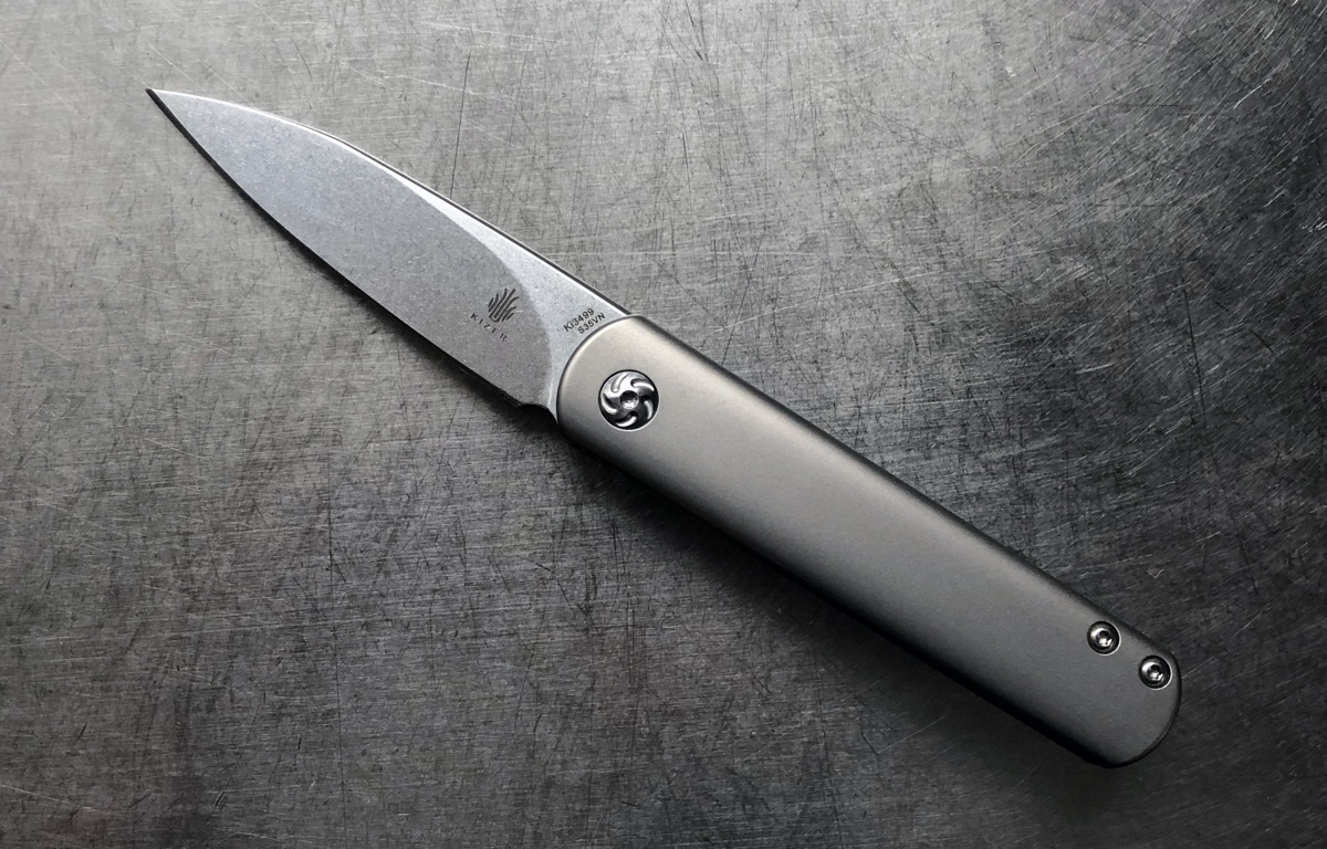

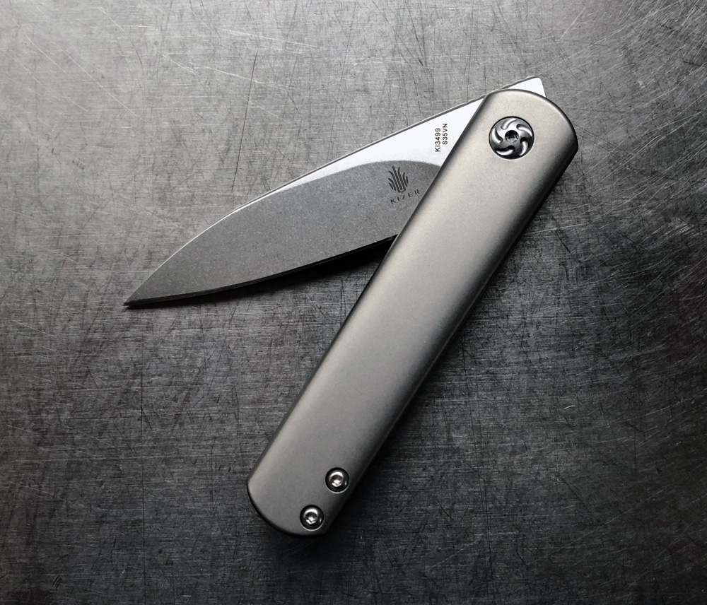

This small knife is surprisingly well-made.
The contoured handle, rounded blade spine, finishes on the blade and the handle, and jimpings, they are all well done.
The fit and finish are great as well.

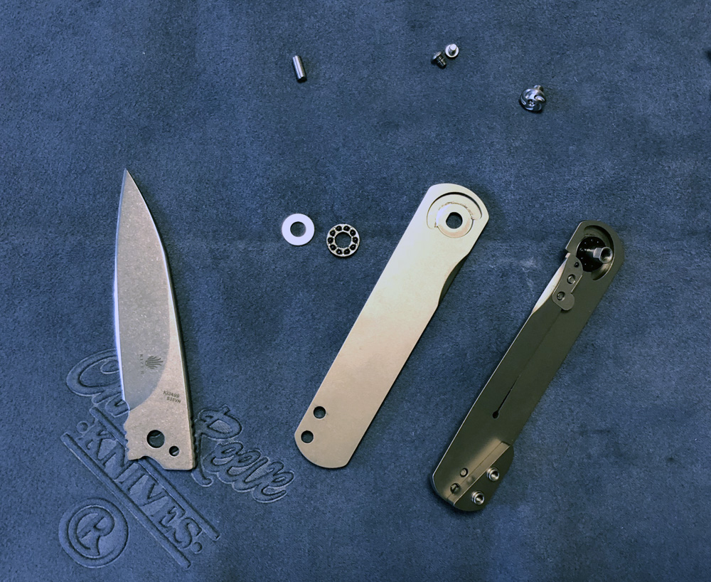

Particularly, the lock bar tension, lock engagement, and the detent ball placement are really perfect.
Also, you can tighten down the pivot and still get the perfect centering and smooth action. I like it!
Mine might be the first generation Feist, judging from the interior, especially the rough stop-pin tracts.
But it operates very smoothly, and I don't have any problem with it so far.
I am glad that Kizer does not do any weight reducing milling to the handle slabs.
Even though it is very light at only 2.65 oz, the Ti slabs give a good weight balance and nice heftiness.
I feel that this is a front flipper version of small Sebenza.

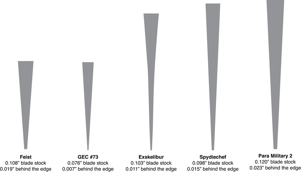

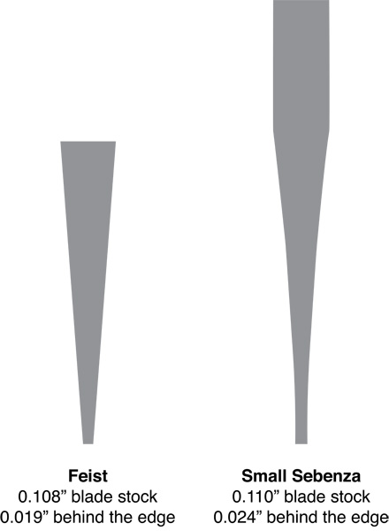

First, the blade.
The blade stock is relatively thin at 0.108".
However, the primary grind is not that tall, and it is not ground thin, leaving the 0.02" edge (the edge bevel was also uneven and asymmetric).
It would be better if the blade stock is thinner or the primary grind is much deeper.
Or, even better with hollow grind like Sebenza.....

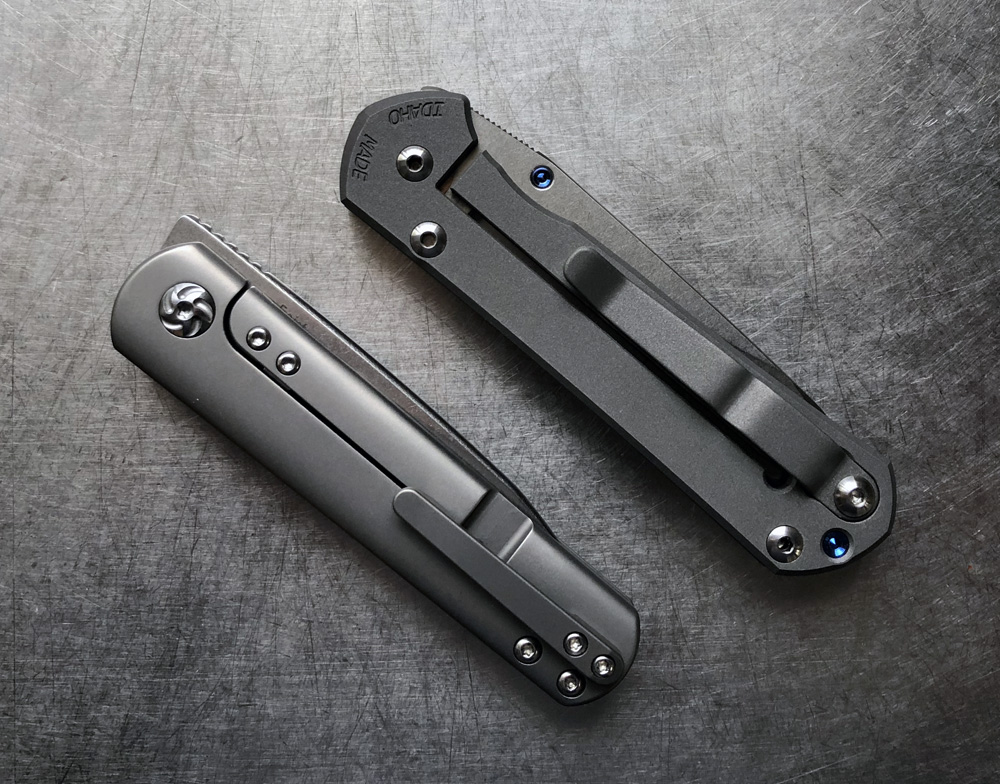

Second is the lock bar insert.
I understand the benefit of having it for makers and users.
But for a small knife like this, I don't think it is necessary.
What I don't like about it the most is that it degrades the bank vault feel of the frame lock......
Also, it would be nicer if there is a cutout on the front scale to make the access to the lock bar better.
The last gripe is about the pocket clip.
It is very short.
But it actually seems to work well.

A terrific review. I really like your cross-sectional representations of the blades. I'm going to look at them some more right after I post this!

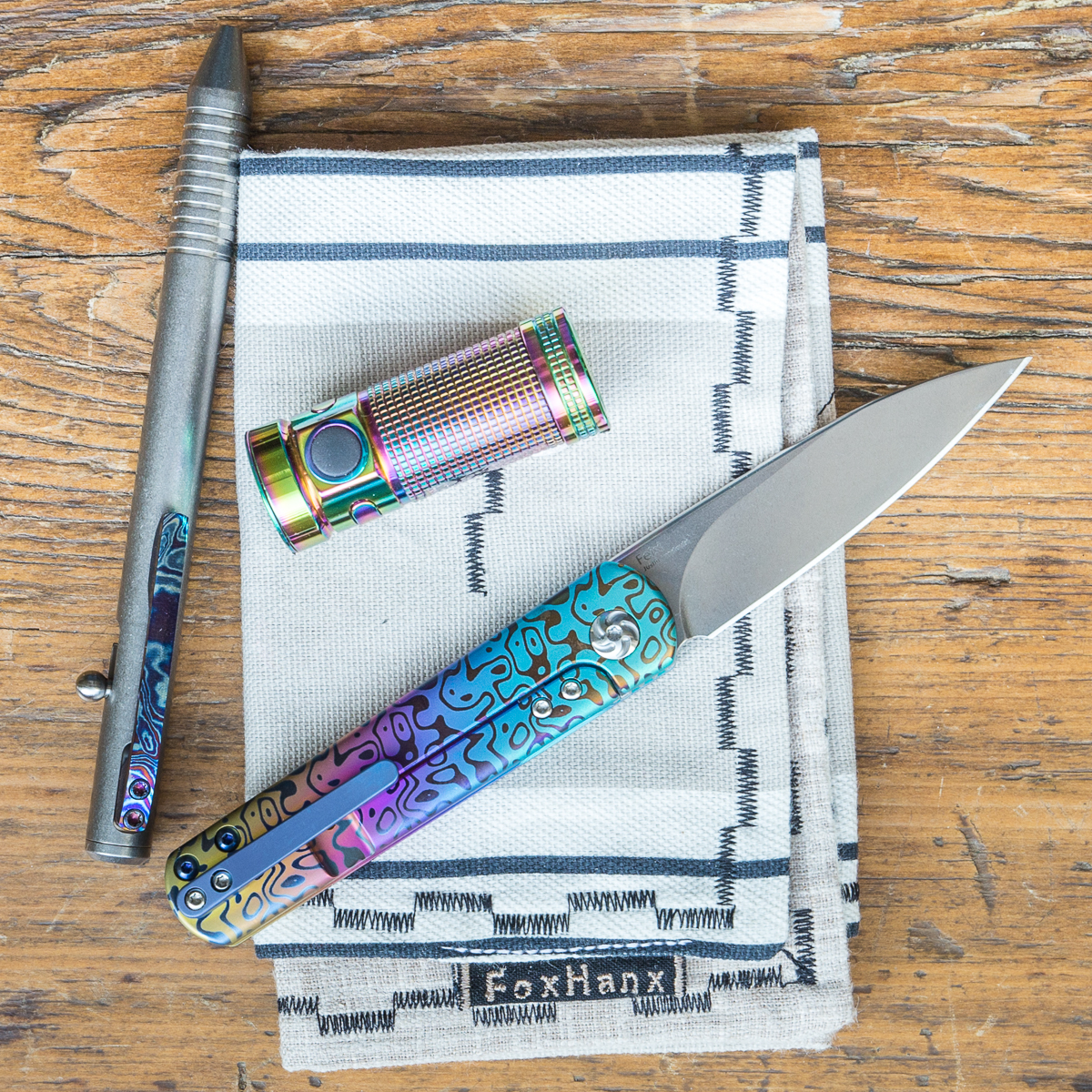

Nice anodization on Feist!
And that plain Shamwari!
Yeah, Shamwari is more of the front flipper Sebenza in design and quality.
I think Feist could be a small flipper Insingo, if the blade is hollow ground or ground deeper......

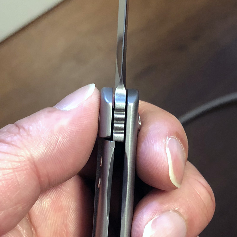

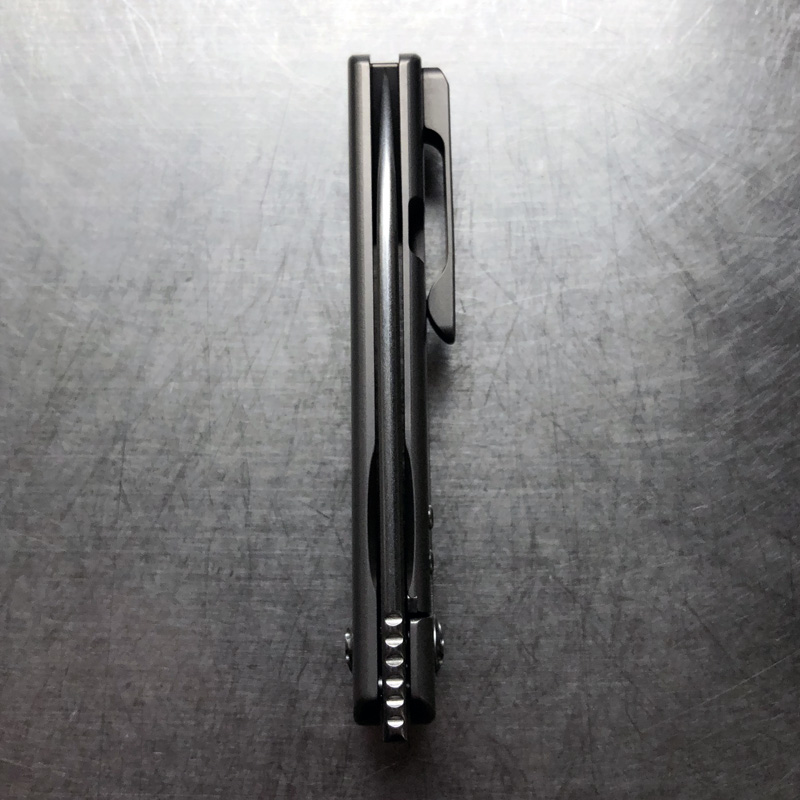

Although Feist does not have a finger groove or choil, Kizer added a front jimping to help holding the knife.

Tons knife makers using lock bar inserts on titanium knives because easy way to prevent lock stickI guess it's hard to carbonize right, Sebenza does it right.

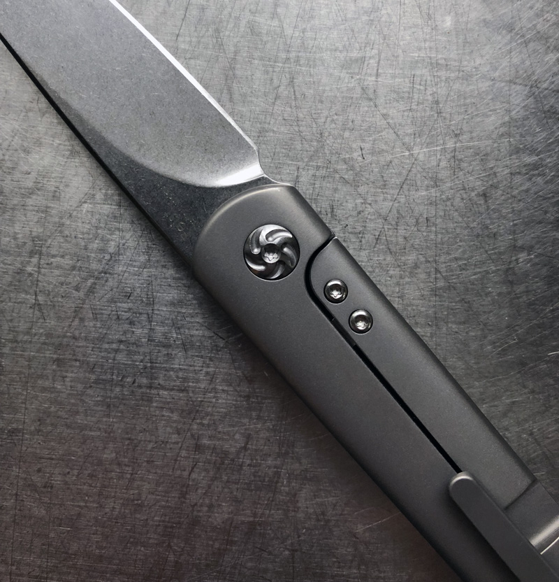

I so hate the pinwheel pivot Kizer is in love with, it just mucks up every knife it's on, save for some of the simpler knives it originally appeared on, such as the Ursa Minor or Gemini. They've really got to ditch this eyesore.

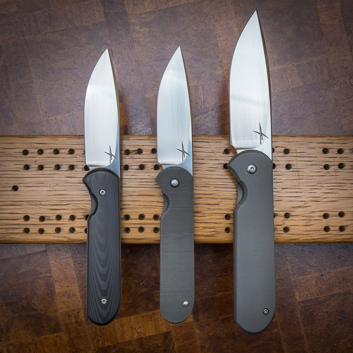

Nice write-up!
Three Shamwaris and that Feist!!!
I also dislike the pinwheel pivot mostly because it has sharp edges.
Simple polished pivot would be better, too.
I don't own Shamwari but know that it has a sink-in type front tab and cannot be opened slowly.
Feist's tab stays exposed from the handle all the time and can be opened slowly.
I am curious which you find you prefer.
Nice write-up!
I don't know about older versions, but with mine the tab stays well exposed the entire rotation, a bit better than the Feist as the bolster is rounder than the Feist.
The action is incredibly smooth, I might prefer the CF liner lock most of all but we're really splitting hairs at this point. The big 3.5" acts just like the little ones.
The Shamwari is superior to the Feist every way, but the fact the Feist doesn't really pale that much in comparison speaks volumes for a less expensive knife. If they improve the lock as you mentioned, better exposure, a bit less sharp, it would be a 5 star knife.
