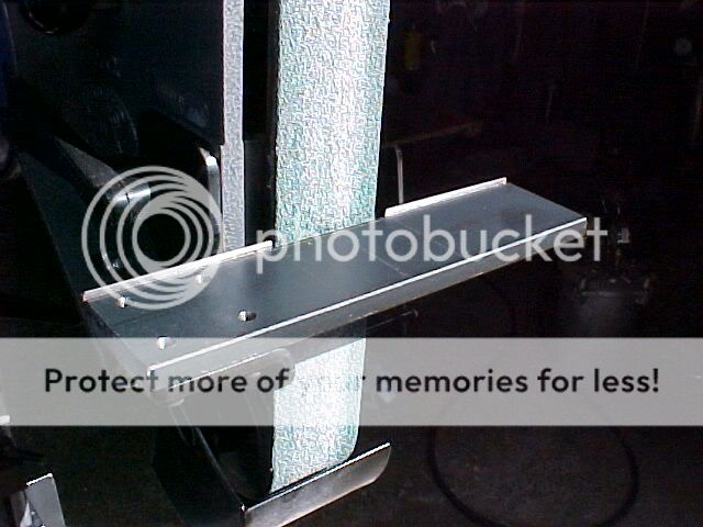

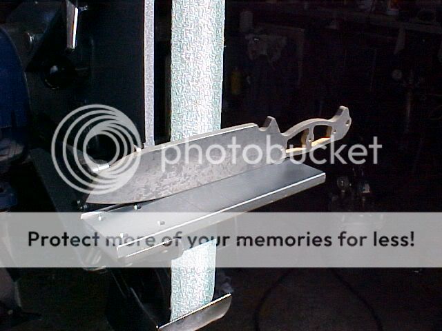

I made a small fence for my platen so I can regulate the grind height by moving the platen in and out.
