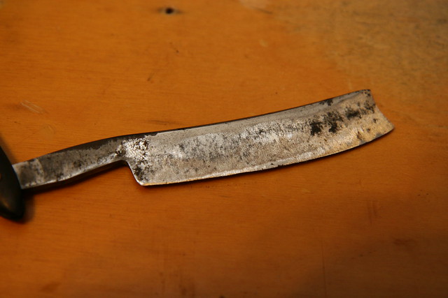

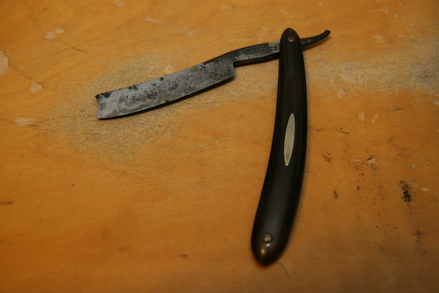

and as for the razor, here are some pictures of it. These pictures make it look worse than it really is though. its actually quite smooth. It just isnt even enough to be able to be easily fixed for shaving.
and a better picture of the blade/blade shape.

You could get that blade to shave again, but it sounds like you have a limited amount of tools available. I dont think it has enough metal for a re heat treat without then having to take the grind up the blade a little, and the thin blades are more prone to warpage when ht'ing anyway. Plus you would have to know what metal it is for proper HT etc...... Putting it in a forge would probably not be the best idea because it is already too thin.
Personally I would clean it up a little and sharpen it rather than try to force it to be a fixed blade knife.
Ya, I believe that it would need a full regrind if I want to get it shave ready, and I have no where to get the tools to do it.
I was thinking either a small fix blade, or maybe a friction folder. The blade section is about 3 inches.
And this is by no means a thin blade (for a razor) this is complete and full wedge. there is no hollow in it whatsoever. When you look at the top of the blade, it looks like this V.
