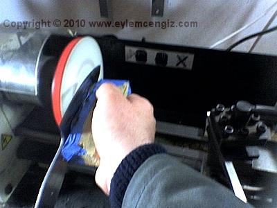

Hi all
Sorry for not contributing with messages up to now. :-(
This is my solution:
I have screwed three countersunk neodymium ring magnets to a piece of wood and taped masking tape over the magnets.
Masking tape solves iron dust problem. When you need to get rid of the dust, you can tape an extra layer and remove all the layers with the dust trapped inside.
