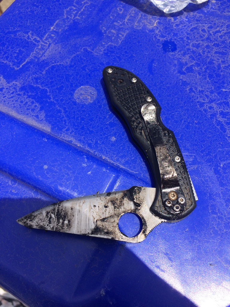

Was actually changing trans fluid in my car and scraped off the old gasket with my delica.
