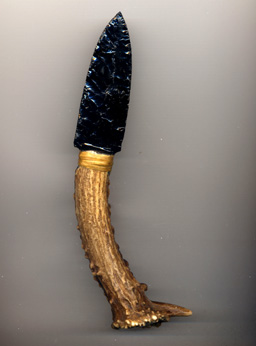

This one's got a really high rockwell hardness.
It's probably been used the longest, too.
