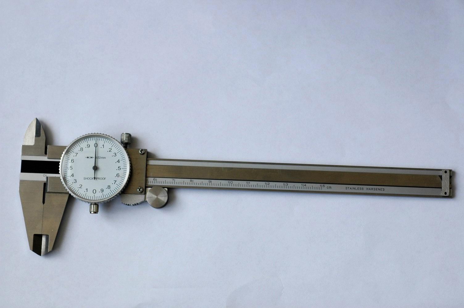

I say, if you don't already have one, get a dial caliper.
As Nathan said, a height guage is the correct tool for the job, but many makers just use a caliper to scratch in the mark.
It is also indispensable for measuring stuff.
You can buy them fairly cheap, even digital ones.

And I absolutely agree with 1-10 that a set of dial calipers is invaluable. I definitely use my calipers more through a day in the shop than my height guage. Both can be had at a reasonable price. Heck, I got my calipers from Harbor Freight, and they work just fine.
