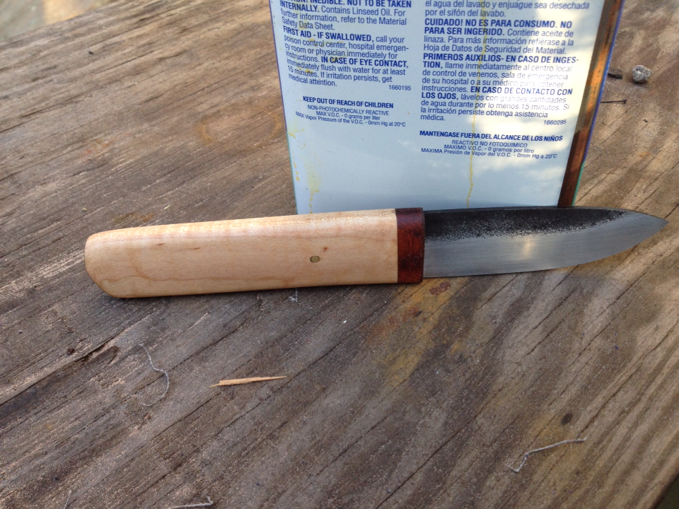

This might not be what you're looking for, but I used a cold blue/bleach etch on my last knife before grinding and it left a pseudo forge finish look on it. Different etch times can yield different textures (this was etched for about 2 hours)
As James was showing, there are several ways to get a dark rough upper bevel for a pseudo kuro uchi look. Etching in FC, Bleach, using Parkerizing, etc. will all darken the area.
