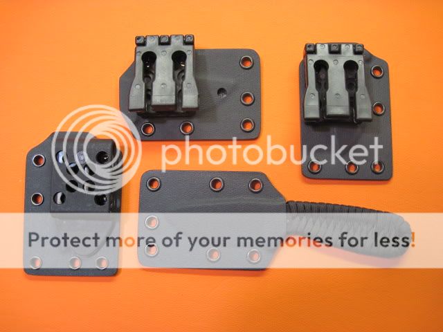

Grommets are spaced for mounting Mini Tek-Loks, or Spyderco G-Clips, for ambidextrous horizontal, vertical, and inverted carry. Edge up, or down, forward, or back. Works well with a Tactical Tether, a Mercharness, a neck chain/cord, an IWB loop, or as a pocket sheath too. I can also do a hook side Velcro backed, removable mounting plate.

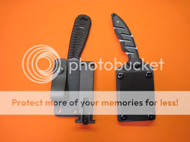

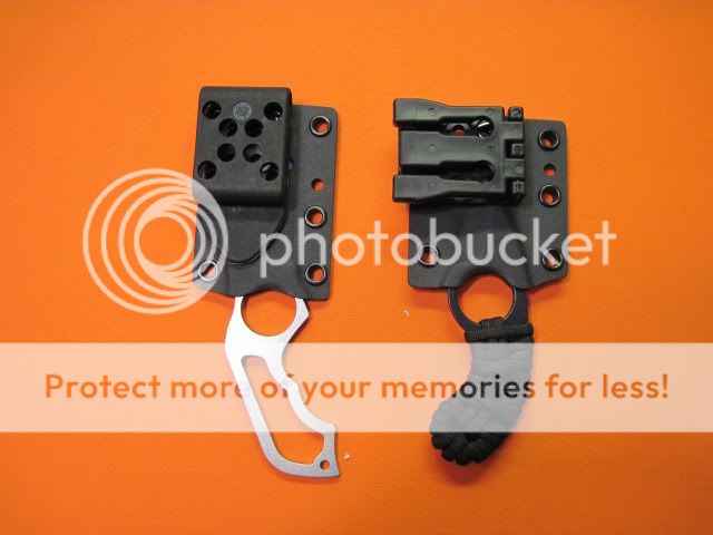

Molle-Lok, and IWB loop on the Izula. Velcro on the Plan B.
Spyderco Swick, and Emerson La Griffe.
Is the velcro held down with screws or glue or both?
Both. It's the sticky backed stuff. I make the plates, drill them, attach the Velcro, then cut the Velcro out of the holes so that the Chicago screws give a little extra hold on the corners of the Velcro.

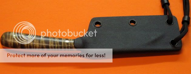

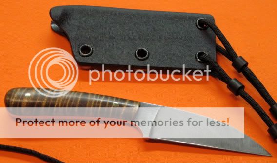

Custom Neck Sheath for a BHK ?. I don't know what the model name is. Very nice knife.
