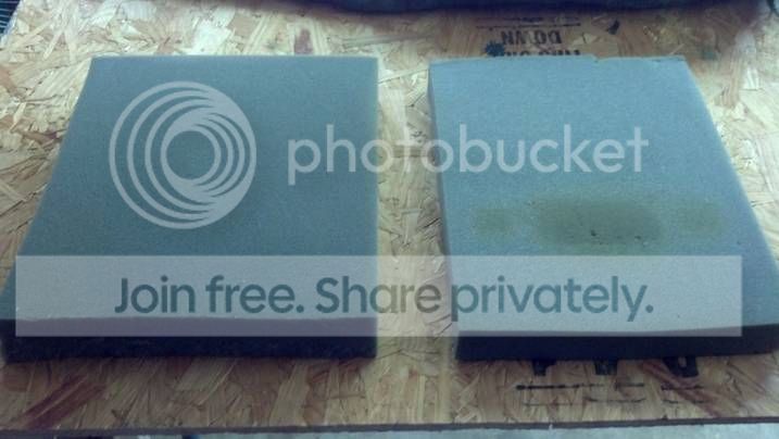

Get a sheet of foam there and cut it in half. Make a press by getting a couple of foot square pieces of plywood, and some door hinges.

now why wouldnt this foam work if i put a piece of cotton as a barrier between the kydex and the foam?
