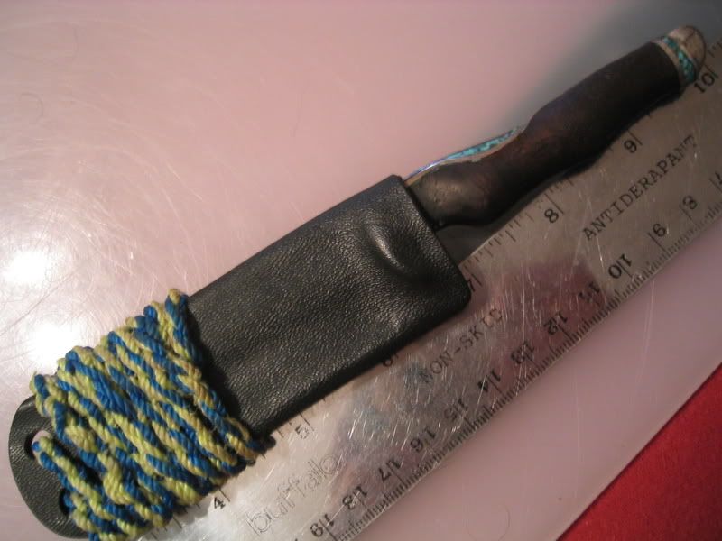

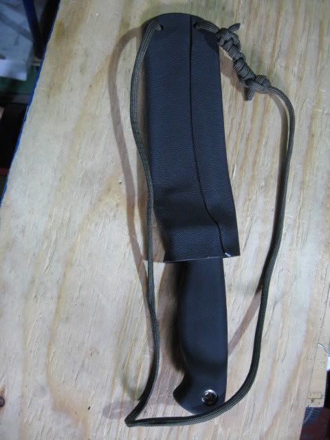

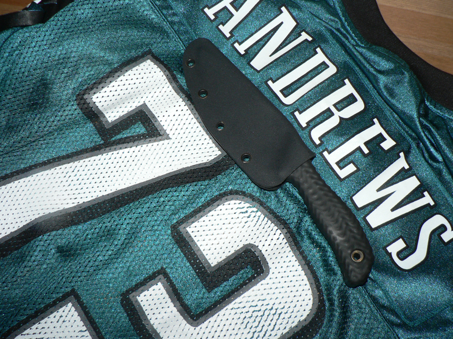

You don't need anything to fasten the kydex except the kydex itself. I have done a number of pure kydex sheaths that saw daily use for over a year each without fail. All that you have to do is leave a little tab to fold over. It would help to have the foam (camping or garden kneepads), but using finger pressure and oven is possible. I have even used a hair dryer to fine tune sheaths- just form a tunnel of cloth around the area that needs work and hit with the dryer long enough to make it malleable. The tunnel keeps other areas of the sheath from getting hot enough to deform. You can cut out the kydex with good scissors or tin snips, or a hacksaw- you really do need some form of tools here though. All you really need is oven and snips and perserverence (and a tolerance to heat burns) and you can get it done.
Here are a couple that I have done:
