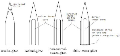

Wondering if anyone could provide more insight on laminated steels. Specifically the type of usage between the laminate that uses a hard core and is sandwiched in between soft outer layer versus that of a soft core and sandwiched between hard outer layer.
Any particular benefits or negatives on using one over the other?
And did one exist before the other?
The edge steel is always going to be hard, high carbon steel. So a typical laminate is going to be the first type. The point of this construction is that the knife could bend past the breaking point of hard steel and will just deform instead of cracking.
The only kind of laminate I can think of with soft steel on the inside is an old type of Japanese sword construction that has a hard edge that wraps up around a soft core. While someone could make an alternate argument, the primary reason for this type of construction is to stretch the relatively rare high carbon steel by filling the middle of the blade with the lower carbon stuff. But a blade that is completely hard on the outside isn't going to behave any differently than a solid hard steel blade. If bent too far, the hard outside steel will crack.
And, as you can see in the picture on the left, you can have an edge laminated to the back, rather than the sides.

Thanks for expanding on the topic. I was thinking that the rarer type with a soft core had to be done for a certain reason as it didn't seem to provide anything better even over a mono-steel. It makes sense that perhaps during times when purity of steel was difficult to come by that the efficiency of saving it and just having it as an outside layer made a lot of sense.
If bent/flexed, stress decreases the closer you get to the center, so if the center is thin enough, it won't crack.
Yes, the outer surfaces will see the highest stress and will start to yield first. If you are using a softer steel, i.e. a less brittle steel, it can yield and deform without cracking. When the user sees that the blade has been bent they should take this as a sign to stop doing whatever they are doing. If you continue to bend the blade, the outer surfaces will continue to deform plastically. The inner core has not reached its yield or fracture point yet so it continues to bend and increase stress elastically. At some point it is possible that the core could reach its fracture point and crack. If the center is relatively thin it would take a lot of deformation for it to reach its fracture point.

The thinner the core the less danger of cracking? The only challenge if the core is super thin could be to match it to the apex of the edge I guess.
