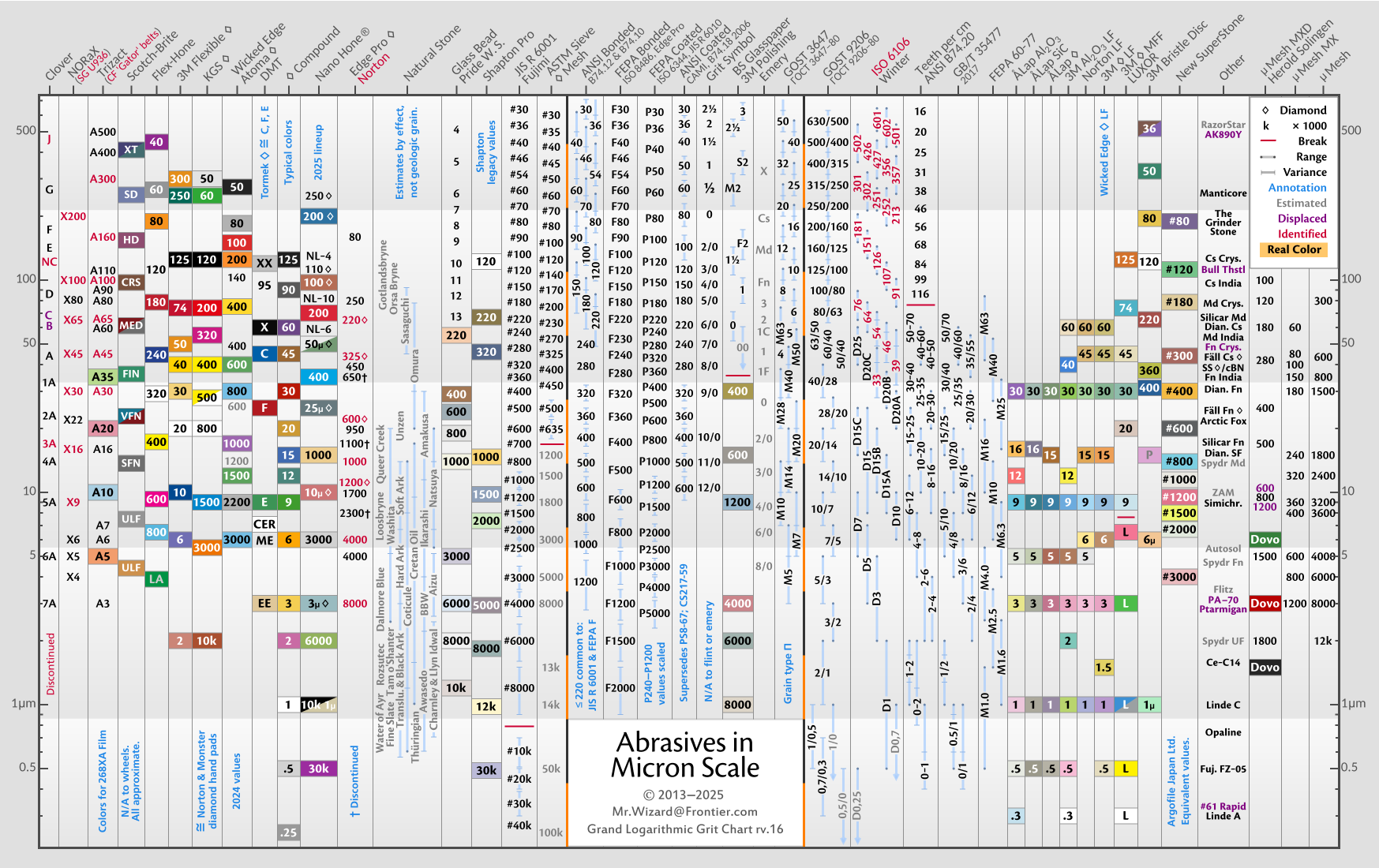

I have the deluxe standard lansky set and the deluxe diamond set. I also have the super sapphire and the leather strop for the lansky set. My question is has anyone seen a published progressive list of all the lansky stones say from the coarsest to the finest grit

If you try to look up the numbers in The Grand Unified Gritchart ( spreadsheet ) they dont quite match up ... but close enough ... seems like lansky has its own grit system thats close to CAMI?

Print Post - The Grand Unified Grit Chart -
http://myplace.frontier.com/~mr.wizard/GLGC/README.txt
http://myplace.frontier.com/~mr.wizard/GLGC/GLGC.png
I guess after seeing those charts and information a better question to ask is should I mix the diamond stones and the regular ones in progressive order or would I be wasting my time with the regular ones until I get to the ultra fine and sapphire ones

Hi,
Yeah, if you're trying to maximize the possible polish,
it only makes sense to
add Fine Blue Hone 600 grit
after using the 600 grit diamond
and after going with lighter and ligher and lighter force using the 600 diamond
if those are your two highest hones
You can strop with compound after that
and increase push cutting ability
and even "mirror" polish the apex (tip of edge)
as the apex is very small (~1micron)
I usually go through the diamond grits from extra coarse to fine (if reprofiling an edge), then move from the fine diamond to the medium Lansky stone, then to fine (red), yellow, blue, and then three leather Lansky hones with green red, and white/grey honing compound. This will usually provide an almost mirror finish edge, which can be refined on a .3 micron film on a flat wood hone.
I used them the other night almost in that order except I left out the medium regular stone and only used one leather home with no compound. Got my ka-bar mule in aus8a shave sharp and functional again. Not really sure if I can get that particular knife much sharper than that but am gonna try on a kershaw tanto next that is 8cr and see what results I can achieve before I need to sharpen my ZT or bad monkey
