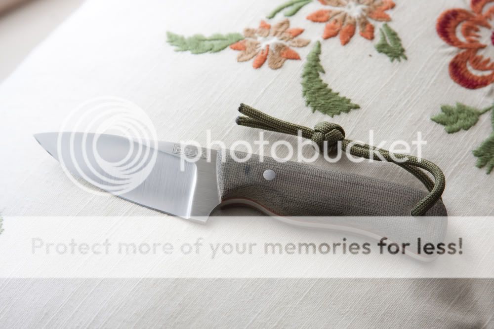

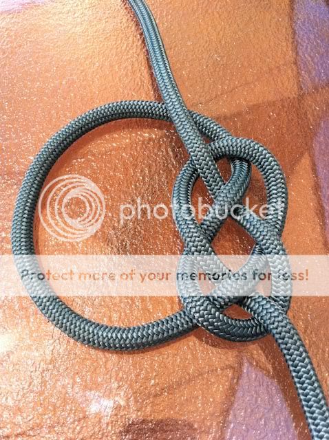

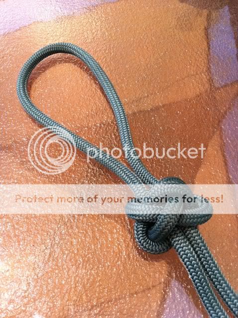

I can tie more knots than you can shake a stick at. The boating, fishing, trucking, and rescue knots are all at my disposal. I exaggerate. Just the same, a nice lanyard knot took me 3 efforts to get right. By efforts, I mean trying and failing on two separate occasions and then finally, a week or two later, getting it right. Most tutorials on the web are horrible for this knot.
It's nice because it is round and symmetrical.

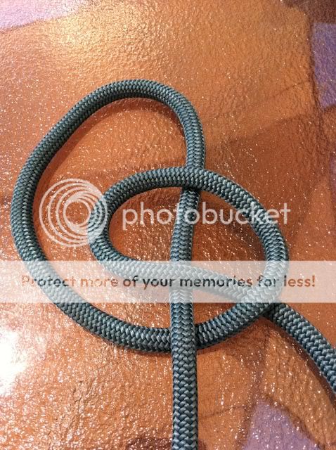

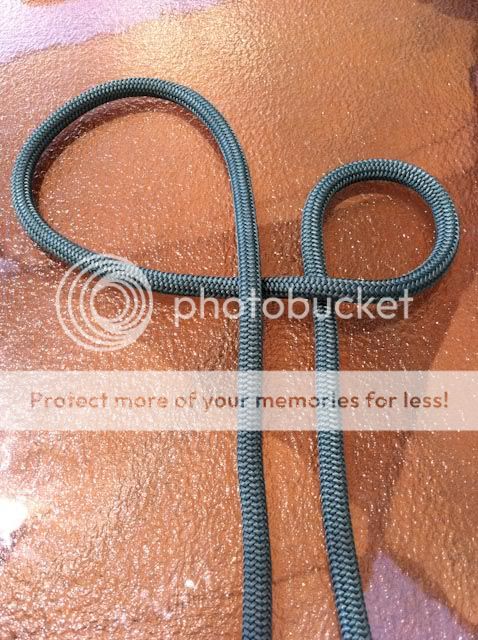

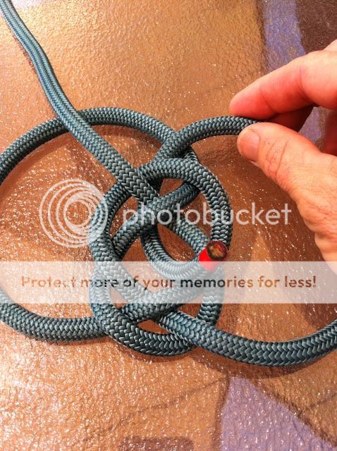

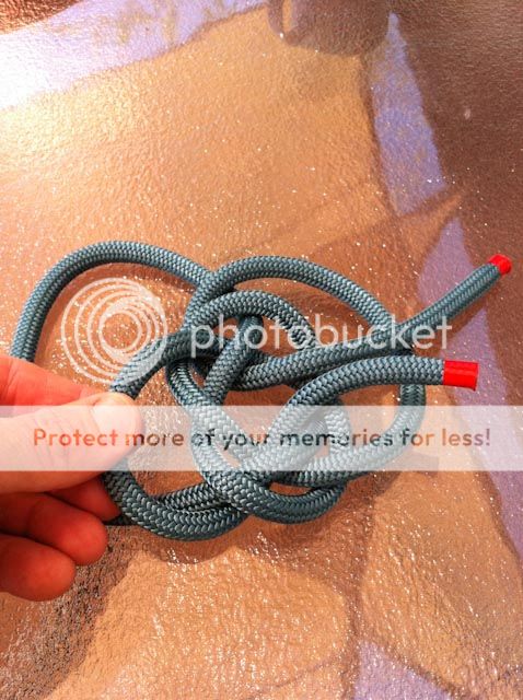

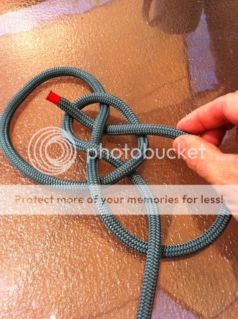

If you want to put a nice lanyard on your knife instead of that overhand knot or figure 8, here you go...
In the first picture, the bigger loop would go through/be where your lanyard tube is. Here's the final product.
