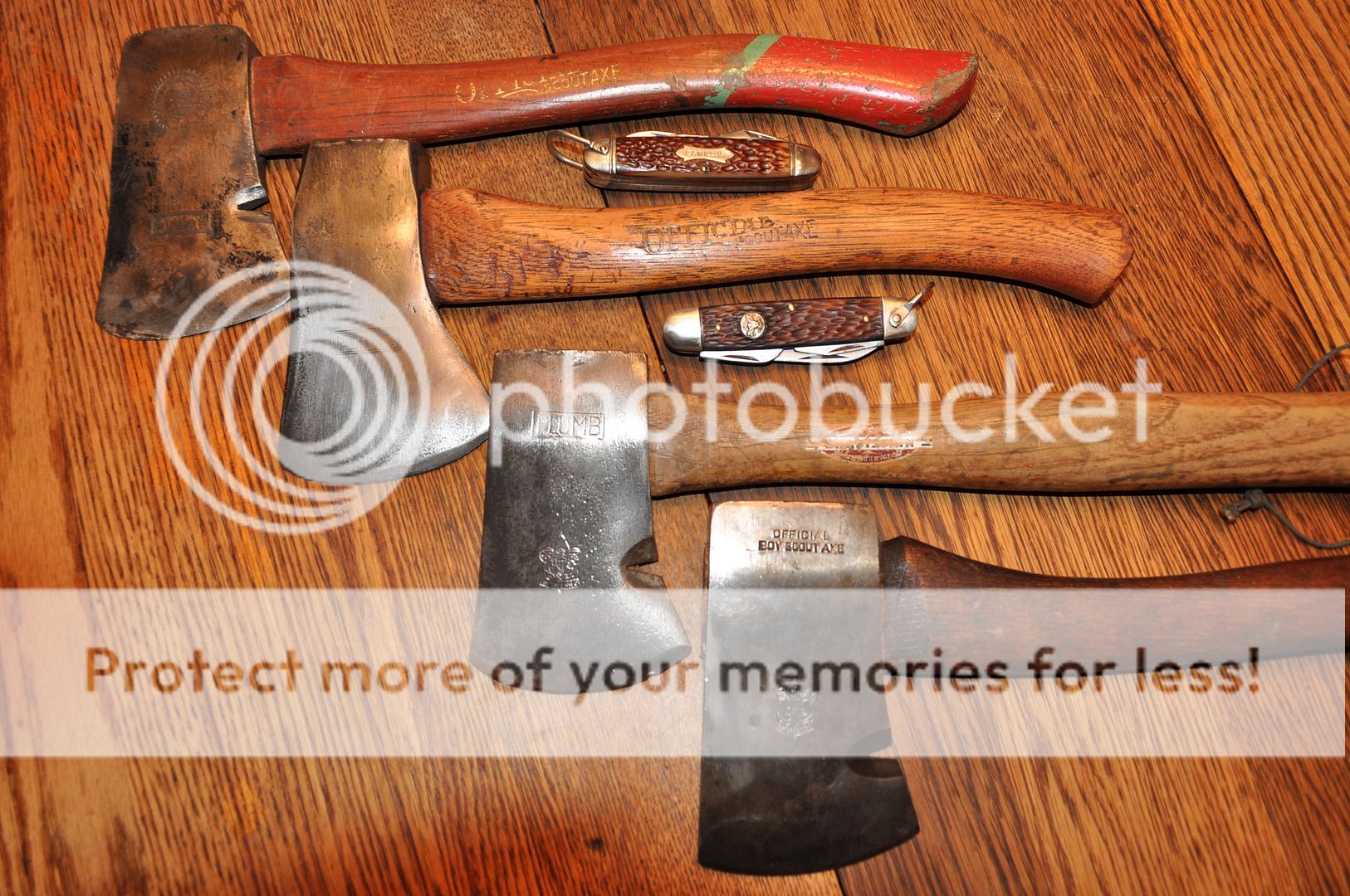

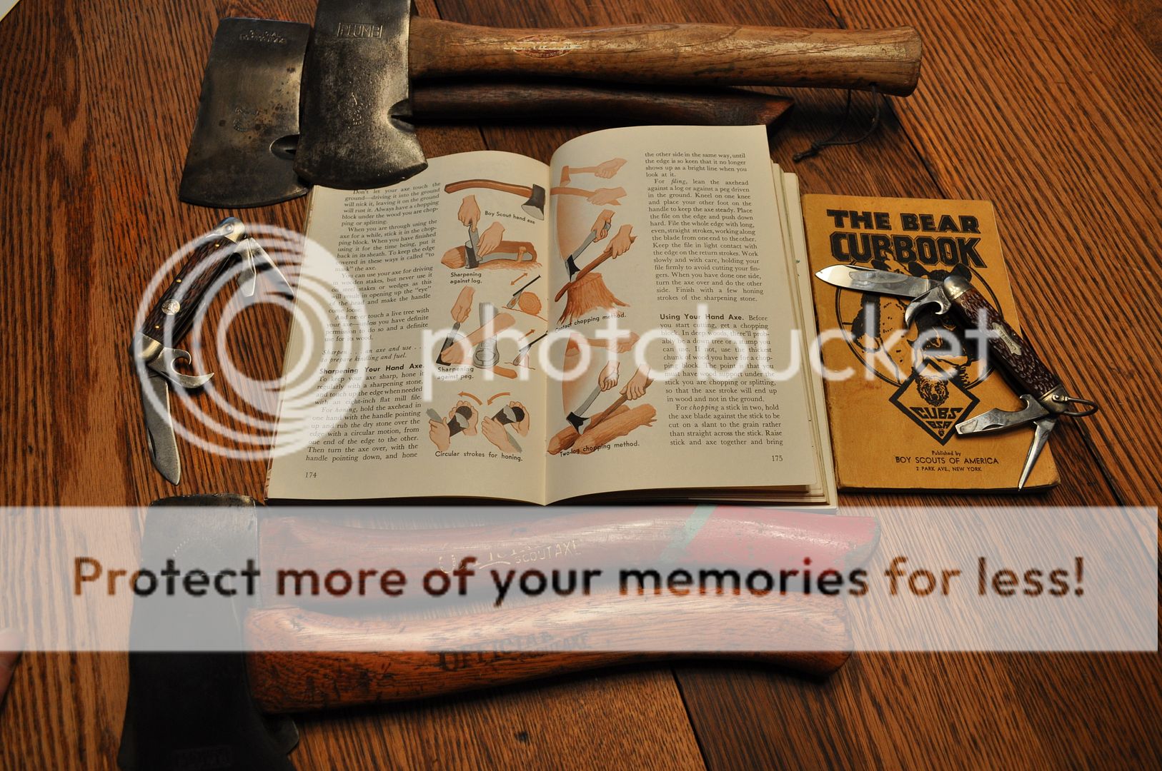

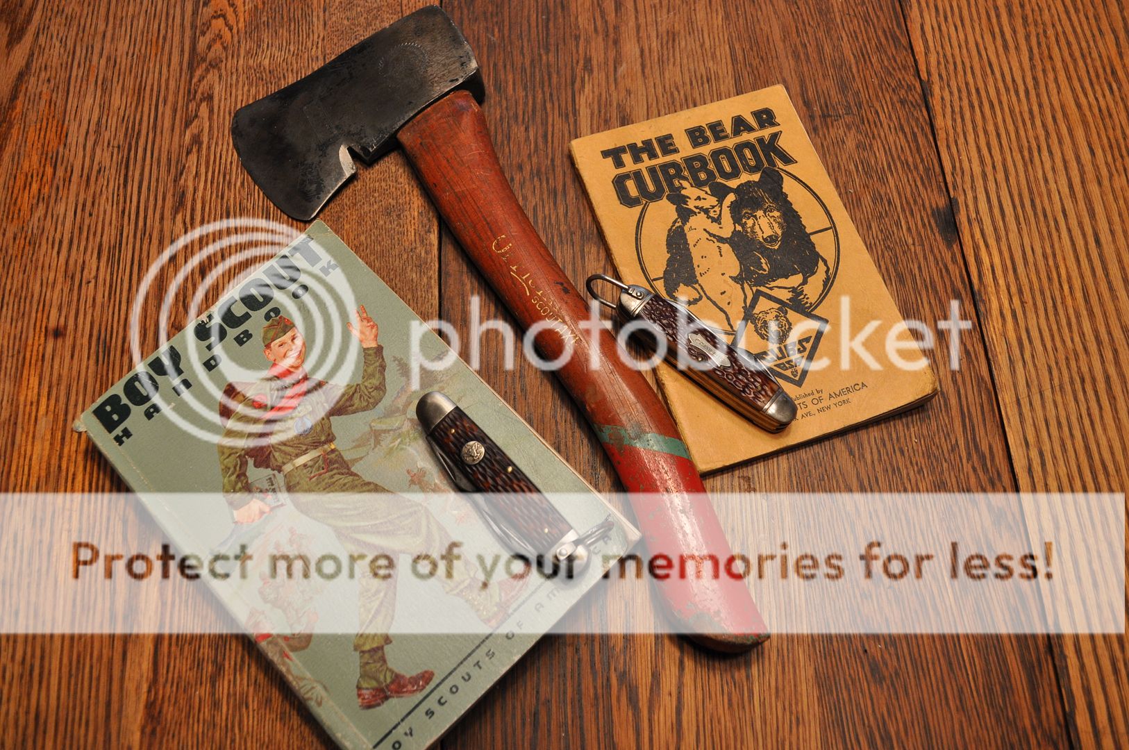

Boy Scout handbook/manual from 1960. Cub Scout manual/handbook from 1955
Complete section on safety how use & sharpen.
