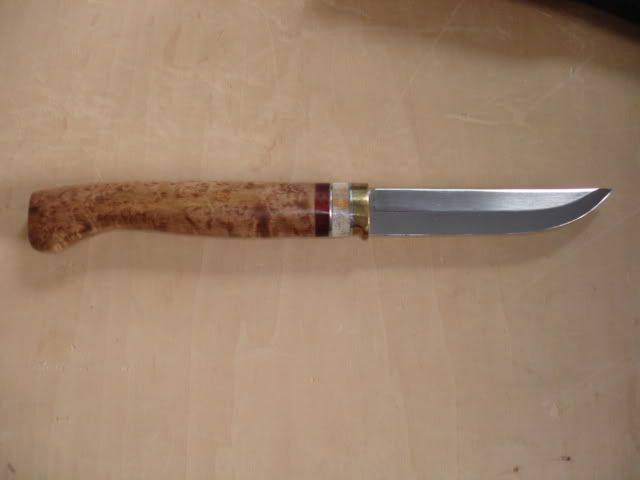

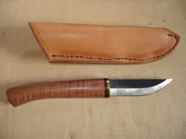

I like them a lot. Especially progressive tempered blades with 62HRC. I made quite a few knives out of it. And with about $15 a blade it is hard to resist.
This is my favorites:
On edge retention tests it shows very good results. Which is expected from good European carbon steel UHB17Va with 62HRC edge.
