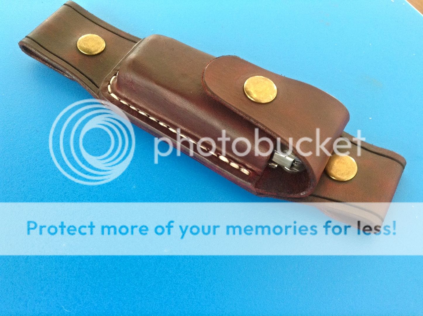

Horsewright: I wanted to make one similar to the ones that come with the wave...it had the flap that snaps and keeps the tool in. Do you make it one piece and fold it? Or is it multiple pieces sewn together. I was going to saddle stitch it, is there a better way or will that work?
For years I wore a surge in this sheath that I bought from my local rural supply shop .
I never bothered to make my own Surge sheath because quite honestly this mass produced one performed perfectly , so why bother .
But I started playing with Beltless sheaths and that meant that the Leatherman started getting left at home .
So I made a couple of Beltless Wave sheaths ( the Surge borders on to heavy for Beltless in my opinion ) and they seem to work well on the occasions I've worn them .
Ken
That's nice. The one I'm looking at making would be vertical, but otherwise similar in design. Could you please list a few steps you followed to make that one? It's a present for my uncle...he wore holes in the case that it came with; I thought it would be nice to make a handmade one.
Nic none of mine have the flap and snap. Not necessary. Here's the three different ones I make:
The middle pic while showing a pocketknife can easily be adapted to a leatherman. So the top one sounds like the closest to what you are looking for. Two piece construction, welt all the way around the tool, skivved to zero except at the bottom edge and the top.
