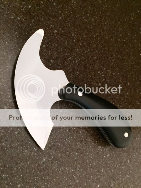

Leather "Round" Knife...first one
Dec 21, 2006
3,158
This was a fun project. A friend who is quite talented in leather working asked to make him a round knife. Confession...I had not heard of a "round knife" until he asked! The design is from "Leather Wranglers", the steel is 1/16" O-1, and the handle is ebony with white/black G10 liners, SS pins. The bevel is a gentle arc from the grind line to the edge, and is quite thin to allow for easy cutting into leather. Thank you for checking it out!
Stuart Davenport Knives
samuraistuart.wixsite.com/knives
samuraistuart@yahoo.com
Interesting and very well done. I'd be very interested in how the knife performs in leather. My best (in terms of performance) custom round knives all started out at about .041 to .045 thickness so 1/16" seems pretty hefty to me.
I now have kind of an accidental collection of 10 round knives, only one of which would be considered "factory", a C S Osborne. Steels that have really performed well for me are M4, A-EBL, and L6.
Paul
I went with 1/16" for my first try. I've seen some online way thicker than that even! As thin as the edge geometry is on the one I made...I think the difference of .020" on the spine is going to be negligible, being the grind is thinned out to zero before the edge bevel was applied. M4 is a favorite, as well as AEBL. As a matter of fact, those are the only two steels I've used besides the regular carbon and low alloy 1080+, 1084, 1095, W2, CFV, O1, O7, Blue 2.
Stuart, for me the extra .020 at the spine does make a significant negative difference. I have a couple that are slightly thicker and can compare the cutting (precision cutting) as apples to apples and the .041/.045 wins by a mile on my bench.
There is also something to be said about being used to and tuned in on the thinner blades. If I had starred out with thicker, I might not notice the difference. Making Saddles and heavier work is done with thicker leathers so the thicker blades can get their "thickness" exposed more in the leather depth and I experience some drag. My thinner blades perform regardless of leather thickness.
Any way you did a really fine job on that knife and I hope to see you making more, especially since we are nearly neighbors.

I will most certainly keep that in mind for the next one! I will try .040". Thanks for the additional info and help, Paul and Harbeer.

.030" at the bolster? Wow. That is way thin. I've never made a round knife before (Didn't know exactly what it was used for....when he said round knife...I immediately thought, "He wants an Alaskan Ulu"). So I did a little research online....found that 1/16" was maybe a little thicker than most, not as thick as others. Definitely....next time I will go .040" for sure. And I really, really do appreciate that input. Geometry is king to me. HT second. Steel selection third.
Paul, I just saw a reply you made on Knife Dogs.....0.042". I will be taking your advice in the future. Just for reference, right now I mic'd the actual steel thickness (after it's all said and done), and it is 0.055" (not a true .063"), and my primary bevel begins 0.666" from the edge, down to zero with a micro bevel applied.
OK, one quick question for you guys. The only steel that I can find under 1/16" is O1 from Flatground. Chuck at AKS has 52100 in .052 (I really like this option....he even has some in the right width. In my shop I have this steel in .052", but it's 2" wide...not wide enough for round knife. I use it for paring knives).
Where are you sourcing .040"? I would love to get my hands on CPM M4 in that thickness. Thanks for the help!

Stuart, didn't you just buy a fancy grinder? :D A few minutes, and you will be at 0.040 even starting with 0.080" stock. :thumbup:
Paul, thanks for sharing this. I watched your videos and could never cut thick leather like you do as my knives drag through the cut, no matter how much I sharpen them. This explains a lot (aside from being a noob at leather work :o)
Duh! Warren....why didn't I think of that? You're exactly right. I should be able to thin stock out quite effectively when that thing arrives! Thank you! Chuck has AEB-L in .078" and Aldo has it .070". I can thin that for sure!
