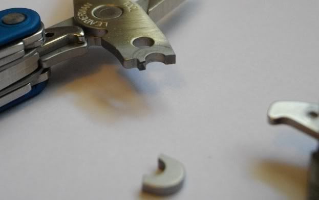

My First impression of the Leatherman Squirt Ps4 was off to a great start It arrived today and like any blade enthusiast I got excited.
I quickly opened up the package and into my hand slid a solid piece of workmanship. I must have played with the damn thing for over an hour then stashed it into my pocket waiting for it's time to shine and save the day.
The hours past and soon I needed a screwdriver so I did what any prepared guy would do I pulled out my new mini multitool I had a tiny laptop screw that needed loosening
and so I used this tool flawlessly or so I thought, turned out the tip of the screwdriver had some marking on it like the steel was not heat treated at all I was shocked but let it slide.
Later in the day I needed to bend a small wire I had all but forgotten about the earlier problem and had just the tool for the job unfortunately I was wrong
and I heard a snapping sound and a piece of metal shot off onto the floor the pliers had broken I had no choice but to laugh because of what brought down this tool was so small i could have done the job with my fingers! I really hope this was a rare problem and I got a bad tool because this was unacceptable
Has this happened to any of you?
Here is some pic's

The Squirt sized plier tools are bound to snap with use. They are really heavy duty tweezers more than pliers, the same gauge as the scissors. The downside of using keychain sized tools. The upside is that Leatherman will replace it.
The jaw shouldn't have snapped with normal use, so you got a lemon. This can happen with multi-tool pliers because they are cast metal, not forged like any decent dedicated tool. Castings are never as strong as forged steel, but usually hold up well enough in normal use. Very occasionally, a substandard casting can find its way into the manufacturing process and be not detected until discovered by some unlucky customers. That's probably what happened to your sample.
Here's hoping you have better luck with the replacement.
That's not entirely true, znapschatz. They are not as strong for a given thickness as a forged tool. There is an ongoing friendly rivalry in the gun world between Ruger and S&W. People think Rugers are invincible because they are thicker. But they are investment cast, rather than forged, so they NEED to be thicker. Some of the Ruger designs are stronger though, aside from the metallurgy.
That, or they tempered it to the point that it became brittle. (not sure if they're tempered at all)

Well I received one back it in the mail today Friday may 4th they did not bother to give me any answers or even write me back.
It came with some red discoloring on the scales that was not there before so I don't know if this is the same one or a refurbished all I know is i doubt it was new. the fact that they sent me one back is good and it's been doing fine so far! so I hope it was just a poor heat treatment on the last one.
