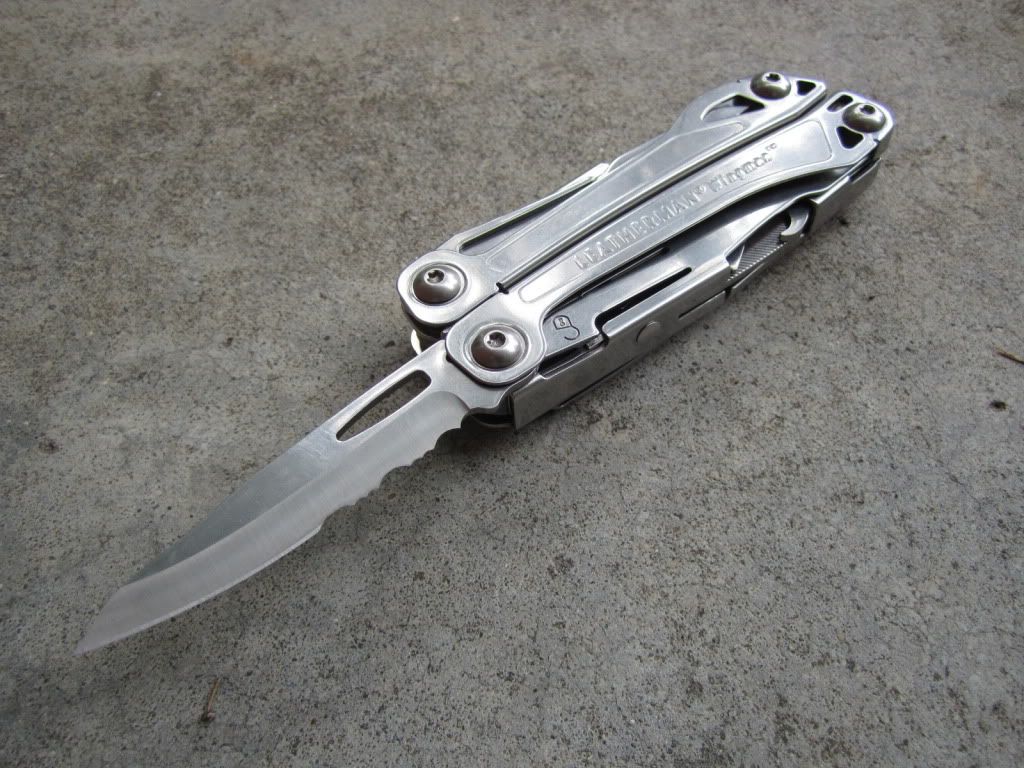

I received a Wingman yesterday from a well-known online retailer. Home Depot has 23 per store, but they aren't on the shelves yet.

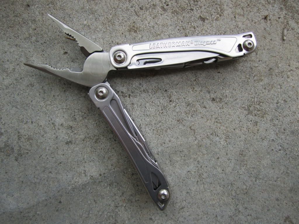

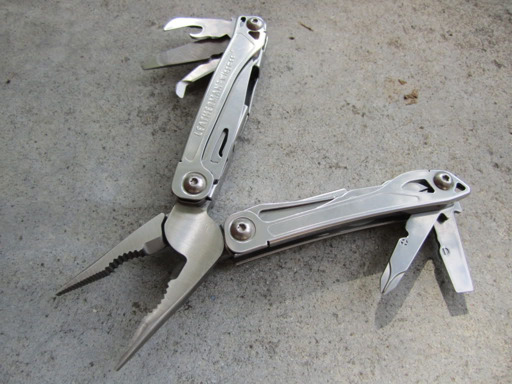

The Wingman, which retails in the $29.95 - $34.95 range, is definitely a step down the food chain from its more expensive siblings. The thumb pad for the scissors, for example, is tiny and not comfy. I would go so far as to say its poorly designed. And the rolled edges of the handles just seem a little cheapish. The wire cutters do not overlap slightly to provide a cutting action as with other MTs. On the Wingman, the wire "cutting" surface - actually more of a crushing surface - is not machined and simply butts up against each other when closed. It has a 2-dimensional phillips like the Wave (though not removable like that of the Wave), but I knew this going in. 3D is always preferable. Has a pocket clip, but no sheath. The clip is good, and may be removable, though it hard to tell. With the clip removed, that pivot/torx may be too long.

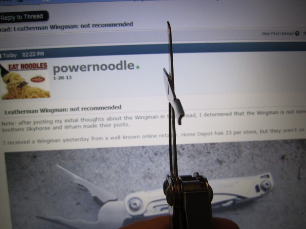

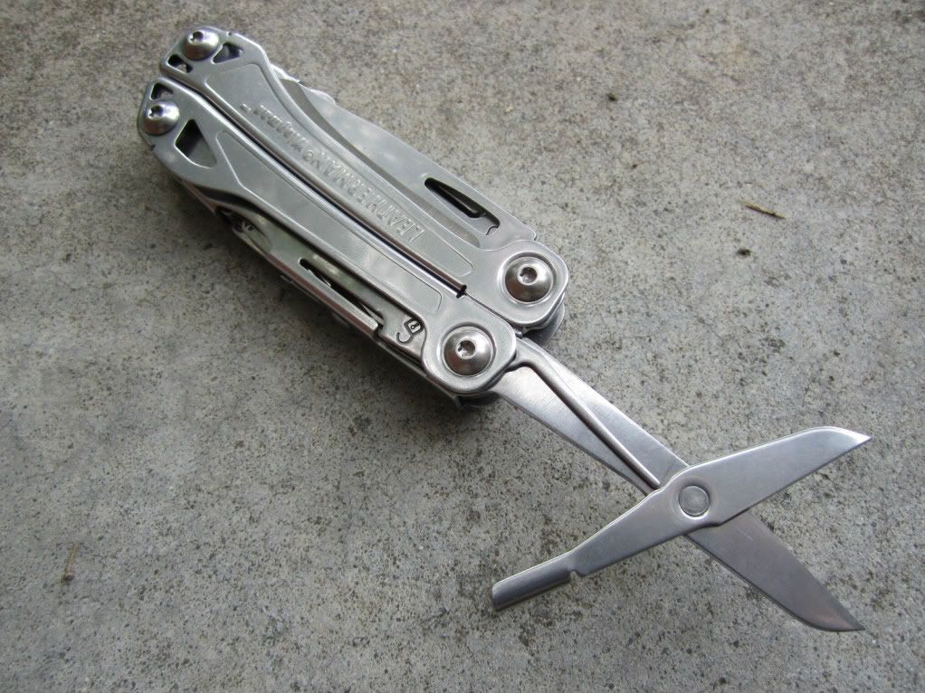

Upon using the Wingman, it became apparent that the lock on the scissor would disengage spontaneously, which rendered the scissor inoperable because the scissor spring tension is dependent on the lock engagement. Additionally, the scissor can be very difficult to deploy as there is no nail nick or other means of extracting it. If it resides too far down in the body of the MT, there is no easy way to get it out. Honestly, this design and implementation is like a Chinese piece of cr@p. When using the scissor, its very easy to push the thumb pad down past the opposite scissor arm, which it clearly is not intended to do. This is due to the tiny, curved profile of the thumb pad and the play in the scissor pivot.
Teeny thumb pad on scissor.

I love the spring loaded plier. Every MT should have that. The blade and scissor each lock, but the drivers, file, clam shell opener and can opener do not.
But overall, I would advise against purchasing a Wingman because of its design and assembly issues - at least on my Wingman. Poor thumb pad on the scissor that hurt the thumb. Crappy lock which won't stay engaged and makes the scissor unusable. A wire cutter which, while it may function, does not incorporate the design of the PS4, Wave and other models with cutters that have a machined cutting surface.

Nice pics there powernoodle. I can see just how cheesy those scissors truly are. This is one I'm staying far away from thanks to you. The Rebar sounds promising however.

Until your Wingman breaks in a bit, push down on the Scissors tip after you open it. I think you'll find the lock snaps in pretty well. Yes - I do have two of them and that's what I've found.

I couldn't agree more on how useless the scissors are. The scissors on my SAK Classic are far more useful.
Something I noticed on one of Powernoodles pics is what looks like a spring on the scissors. Mine didn't have any kind of spring. When you close the scissors they stay closed which makes them useless. I bought mine online and as it turns out a local knife shop I went to a couple of days ago had one that didn't have any spring either, the scissors stay closed after one cut.
